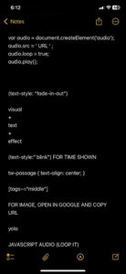

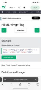

(Images; Google searches, unfinished prototype sketches, running notes @ phone)

The best answer I can give you...spend time in the program. Click on each button in the workspace, Google it, click on it again and use it within a passage. If something doesn't work, delete it and try it a different way.

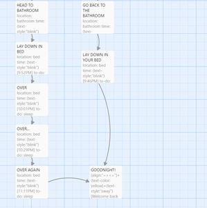

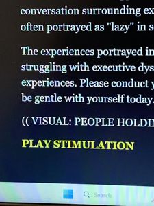

(Images; starting workspace (2 hours into work), picture of testing screen, picture of passage in progress)

While you are working, put on music, put on a show, search up what you are confused about, because there is most likely an answer for your question somewhere. Take frequent breaks and don't give yourself a headache over a project that is supposed to be fun.
After I was done with the passages AKA the whole story, including inserting visuals, adding transitions, and aligned code, I figured out background sound by searching up multiple tutorials.
You are done with the project when you say you are done with the project. Well done!
(Images; Twine workspace (finished project version), Harlowe audio tutorial for Twine)
