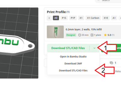

  1. Rectangular Rounded KeychainDownload here on Makerworld
  2. Round KeychainDownload here on Makerworld

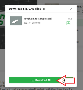

Download the .scad file for the keychain model you want to customize.

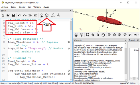

Open the file using OpenSCAD.
The keychain dimensions are defined in millimeters (mm) by default. If needed, you can modify the following parameters to adjust the size of your keychain tag:
  1. Tag_Height: Defines the height of the keychain.
  2. Tag_Width: Adjusts the width of the keychain.
  3. Tag_Diameter: Used only in the round keychain to define the diameter.

  3. In OpenSCAD, run the file to render your keychain with the logo.

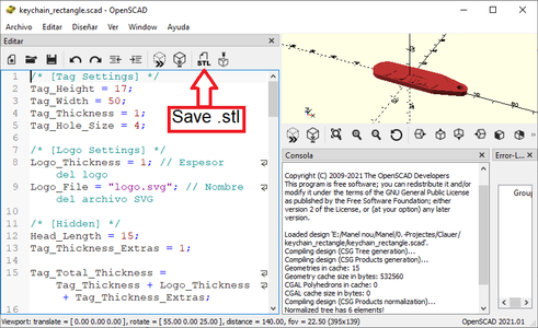

  1. Export the model as an STL file.
