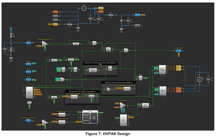

The HVPAK design is shown in Figure 7.
The PWO0 block provides a ~100 kHz signal with a PWM depending on the motor`s rpm. The CNT2/DLY2 ensures stable functionality of the motor by smoothing the UP/DOWN motor speed signal. The CCMP0 checks the current on the HV OUT CNTR 0. If the current is higher than the maximum allowable current, the PWM Chopper 0 chops the PWM to avoid overcurrent. Then this final PWM signal goes to enable input of the HV OUT CTRLs blocks. They are both configured as Full Bridges. PIN 7 and PIN 9 are in parallel and connected to the first motor`s terminal. PIN 8 and PIN 10 are in parallel as well and connected to the second terminal.
The DFF6 and MF3 form the signal of rotating duration and direction - 10 s for both directions. This signal goes to PH inputs of HV OUT CTRLs. The MF4 provides the delay of direction changing – 250 ms. This time is enough to create eddy currents of water and not overload the motor. Through this delay, HV OUT CTRLs, PWM0, and OSC1 are powered down due to a HIGH signal on the Sleep stage (3-bit LUT2).
Input PIN 14, PIN 3, and PIN 17 are timer selectors of 10, 20, and 40 min, respectively. 3-bit LUT4, 4-bit LUT0, 3-bit LUT5, DFF2, DFF3, and MF0 provide selection functions depending on a chosen time mode and create a signal with the corresponding duration. After this time, the Sleep signal is HIGH and the system is powered down.
The ACMP0 checks the VDD2 charge, if the voltage is less than 11.8 V the Sleep signal is HIGH and the system is powered down till the voltage is higher than 12.05 V.
The 2-bit LUT3 is a selector for the LED state between the Pipe Delay signal and the timers` signal. The green LED notifies about normal device operation. The red LED notifies about the end of the program. An alternate strobe of green and red LEDs means that the battery is discharged.
