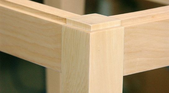

On finishing the dowelling jig I was immediately inspired to construct a matching end table. Set up time was only minutes and the results were perfect (photos 5 and 6). A trial run to check accuracy is an option, rather than a necessity.
The wood cost nothing (all scraps), the threaded rod and nuts less than $15 (a friend did the welding), and the lathe bed $45. Design and construction took a weekend. Not bad value for a device that will join four corners of a construction (eight joints) dead accurate, square and flush in minutes. With hours of mortise and tenoning time saved!
