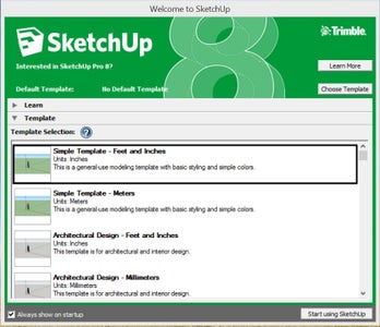

2.1 Click the short cut for SketchUp 8 on your desktop
2.3 You're going to want to start a template to begin our bridge. Most of the world prefers to use the metric scale, but were going to use Feet and inches for this particular tutorial. Click choose template and then click feet and inches, which is the first option.
2.2 On the bottom right of the window, click "Start using SketchUp"

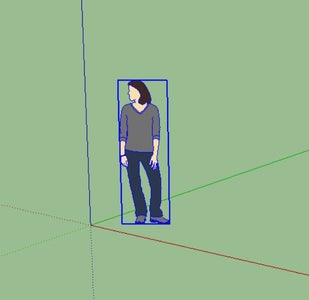

When the program starts up you're going to see the image of a girl near the origin. Some people like to leave her in as a reference so their model is scaled to a person in real life. She is unnecessary for this particular project so we are going to delete her.
4.1 Select the pointer tool
4.2 Click on the girl
4.3 Press delete on your keyboard

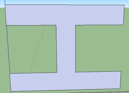

6.1 Using the rectangle tool, draw a plane in the axis shown in image
6.2 Draw 1 foot by 9 inches rectangle by typing in 1', 9".
6.3 With the eraser, delete all of the square outside of the new one you just drew.
6.4 Draw 2 horizontal lines 3 inches from the top and bottom of the new square as shown in picture.
6.5 Draw a vertical line directly in the center from the two closest parallel lines.
6.6 Use the move tool and select the vertical line. Hit CTRL and it will clone the line. Move it both one inch to the right and one inch to the left.
6.7 With the eraser tool, delete all lines that do not belong in our beam. By the end it should look like a capital I.
6.8 Next we select the push/pull tool and expand the beam 25 feet out.

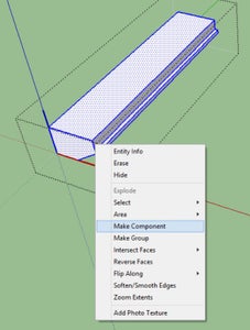

6.9 Double click the beam with your pointer tool, then right click and choose "Make Component."

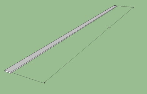

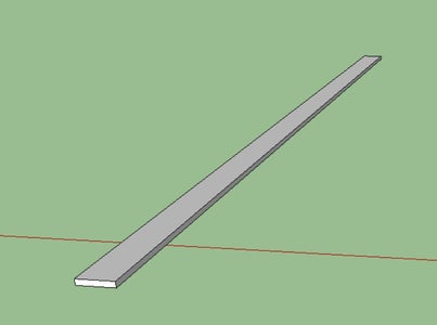

7.1 With the rectangle tool draw a 6 inch by 1 inch shape.
7.2 Push it out with the push/pull tool 25 feet.
7.3 Double click the object. Right click and hit "Make Component."
