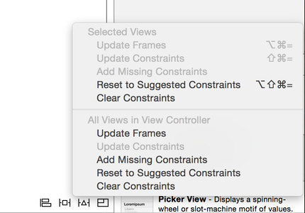

3C. Add the ‘Date Picker’ object to the top of the screen. Click on the icon at the bottom of the Xcode window that looks like a triangle between to vertical lines, then click on the ‘Add Missing Constraints’ option.
Note: You can position the ‘Date Picker’ object anywhere on the screen that you’d like. Constraints will make sure our Date Picker object fits correctly on different size iPhone screens.

3I. Add constraints to the Label object by clicking on the icon at the bottom that looks like a triangle between two vertical lines, then choose ‘Add Missing Constraints’.

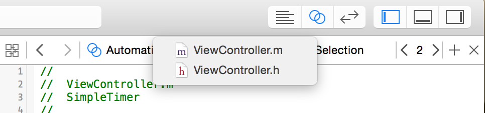

4D. Click on the overlapping circles in the top right hand corner of the Xcode window to start creating methods for the Start/Stop buttons and Pause/Resume buttons.
Note: Our ViewController.h file should open. If it doesn’t open the ViewController.h file, see the pictures above to select ViewController.h.
