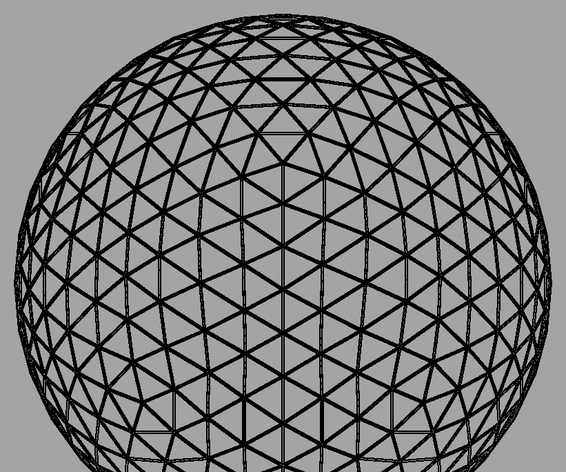

Introduction: How to Create a Temcor-style Geodesic Dome in Autodesk Inventor
This tutorial will show you how to create a Temcor-style dome using only a little bit of math.

Create a Thicken/Offset of the bottom rows, omitting the last two rows of triangles. Pattern the new OffsetSrf 6 times, or ((Frequency=14)/2)-1. Hide the OffsetSrf, stitch the patterned surfaces, then mirror the stitched surface with the YZ Plane. Create work planes resting on the vertices of the top triangle, as shown in Image 6. Trim the stitched and mirrored surfaces using these new work planes, then stitch the remaining surfaces together. Pattern this last surface across the Z axis, then stitch these final surfaces together, and you're done!
Step 8: Checking Chords
So, our dome is finished, but let's see if the numbers match with TaffGoch's model:
Going by the reference parameters, it looks like they are a perfect match!
Dividing the chord lengths by 1000, we can clearly see a perfect correspondence with the chord factors of TaffGoch's model, as well as the footprint radius and apex factors.
