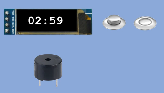

We need following parts to build this project:
  • Arduino Nano
  • Buzzer
  • 2x 1k Ohm resistors
  • Oled I2C SSD1306 display

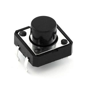

  • 2 push buttons

Step 2: Connectivity
Let's discuss connectivity. As always we are connecting five volts and ground arduino pins to ground and 5v sections of the breadboard. Then we connect 5 volt to left pins of both push buttons the other pin of the first push button goes to digital pin 2 and via pull up resistor to ground. Same for the second push button it goes to digital pin 3 and via pull up resistor to ground.Then the buzzer is connected to pin 12. And OLED display is connected like shown in the diagram.
