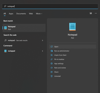

Step 1: Open Notepad
Open Notepad app on laptop
-Click on the Windows icon
-Type and select “Notepad”
