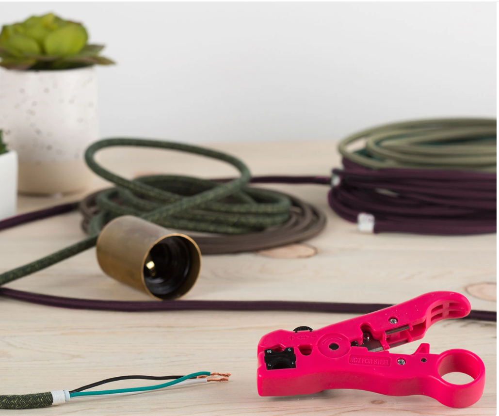

If you’re using cloth-covered cord, you’ll need to expose the copper wires on the interior to make wiring simple.
To start, place a strip of masking tape around the cord about an inch and a half from the end. Using your razor blade, cut at the center of the masking tape all the way around two or three times. At this point, you should be able to pull away the cloth or PVC housing of your cord to expose the positive, negative, and ground wires.
Step 3: Wire Prep
Using your wire strippers, remove about 3/16” off the tips of the three interior wires. You should now see the stranded copper wires underneath.
Tin the ends for a better contact point in your completed modern wood pendant light. However, you can also simply twist the strands tightly together with your fingers.
