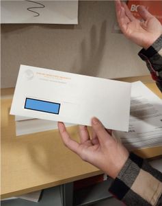

For this tutorial we will be choosing the Z-fold, as our needs are for the recipients address to appear in a window envelope.

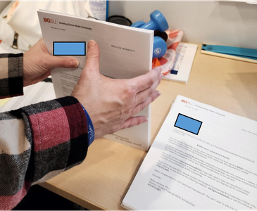

In order for the machine to pull each paper successfully and to prevent the machine from jamming it is important for the stack of paper to be straight with no lose papers or jagged edges are visible.
With a little force, tap the stack of paper on a flat surface making sure to tighten the stack so all the edges are nice and straight.

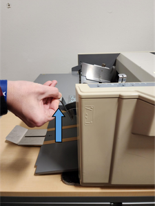

Next, you will place the metal handle on the left side of the machine to the up position to open the tray for the paper folder.
You can do this by simply lifting the metal handle up.
This allows the paper tray to drop and to be in the proper position to place the paper in the machine to begin the folding process.

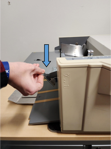

Next, you will move the lever to the down position, simply by pressing the handle down.
This will tighten the grip and secure the paper into the machine to start the folding process.

They are now ready to be placed in your envelopes for your mailing.
