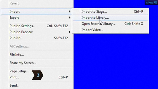

Step 3: Import Pictures
Import your pictures by going to File, Import, Import to Library. Browse the pictures you want to import. You can select multiple pictures by holding down the Control key and clicking multiple images. Once you've selected your images, click "Open." You'll see the imported images in the Library panel.

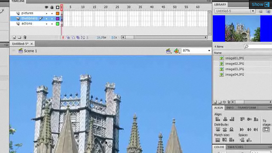

Step 4: Create the Thumbnail Menu
With the Thumbnails layer selected in the timeline, drag one of the imported images onto the document. In Properties, click on the chain-link icon to unconstrain the width and height values. Then, resize them both to 100. Position the image at the bottom left of the document. Repeat this process for the remaining images so that they are in a row at the bottom of the document.

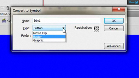

Step 5: Convert the Menu to Buttons
Select the first image and hit the F8 key on the keyboard. Change the name to "btn1," change the type to "button," and click OK. In the Properties panel, change the instance name to "button1." Select the next image from the menu and repeat the process, naming it "btn2" and "button2." Continue the process for each menu item.

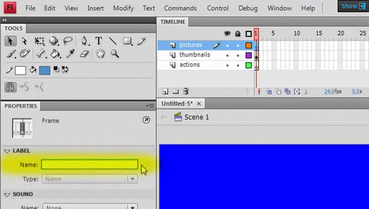

Step 6: Create a Photo Display
From the timeline, select the first frame of the Pictures layer. In Properties, change the name of this frame to "pic1." Drag the image corresponding with the first menu item onto the stage. Resize it in the Properties panel, remembering to click on the chain-link icon to reconstrain the width and height values. Move the image to the center of the document above the menu.

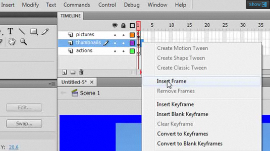

Step 7: Insert Frame
In the timeline, right-click (or command click on a Mac) on the second frame of the Thumbnails layer and select "Insert Frame."

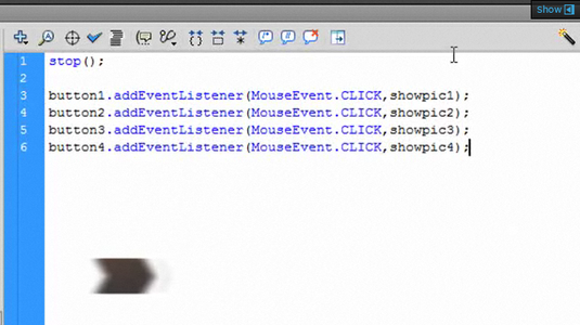

Step 9: Write the Actionscript
In the timeline, select the first frame of the Actions layer and hit F9 to bring up the Actions panel. On the first line, type the stop function to stop the pages from cycling through. Hit Enter. On the next line, write a script that assigns a function to "button1." Call this function "showpic1," and hit Enter to skip a line to write a script for button2, calling the function "showpic2." Repeat for the remaining buttons.
'stop();
button1.addEventListener(MouseEvent.CLICK,showpic1);
button2.addEventListener(MouseEvent.CLICK,showpic2);
button3.addEventListener(MouseEvent.CLICK,showpic3);'

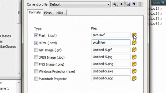

Step 11: Publish and Upload
Publish the web site by going to File, Publish Settings. Check both the SWF and HTML boxes. Rename both files and select a location to save. Then click publish, and upload all of the published files to your web server. To access the flash page, navigate to the HTML file on your web server.
