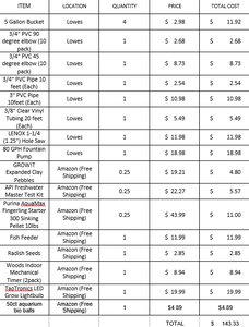

Materials needed: *SEE BILL OF MATERIALS IN IMAGES
LINK TO BILL OF MATERIALS EXCEL SHEET
- 4 - 5 Gallon buckets
- 3.5 feet of 1/4" Clear tubing
- Growth light 12 watt LED
- 7 PVC 1/2" Elbow joints 90-degree and a 45-degree
- 3 feet of 1/2" PVC pipe
- 7" of 2" PVC pipe
- 10" of 3" PVC pipe
- 5 - 1/2" Uniseals
- Automatic fish feeder battery powered
- Electronic water pump 120 volt
- ~5 tilapia
- Fish food
- Cherry radish seeds
- Hot knife
- Sandpaper
- Drill
- 1/2" diameter bit
- Permanent marker
- Expanded clay pebbles (growth medium)
- 1 x 4 x 6 wood board
- Bio-balls
- 5" x 5" Plexiglass
- Hot glue

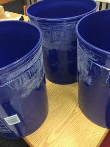

Step 2: Prepare the Buckets
On the fish, sump pump, and swirl filter buckets, mark off 10" of the top lip. Remove the lip with a hot knife and sand away the remaining pieces until you have a smooth surface.
Once sanded, arrange the three buckets to where the smooth edges are touching. The buckets should be in a triangle formation.
For the plant bucket, mark 7" from the top all around the bucket. Use the hot knife to cut along this line. Use sandpaper to smooth it out. Save the piece you cut off.

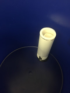

Step 8: Bell Siphon Construction
Cut a 3" diameter PVC pipe 10" and center it over the uniseal in the plant bucket. Hot glue it down. Cut a 2" pipe 7" tall. Mark a line an inch from one side of the pipe. Draw the line along the diameter of the pipe. Pick a point on the line and draw a line straight to the end of the pipe. Measure a 1/4" from the line to the right. Draw another line straight down. Using a band saw, cut along the lines you just marked. There should be two cuts at this point. Leaving the two 1/4" pieces, cut the rest of the pipe off.
Using the bandsaw, cut along the line until you get to the 1/4" nubs and do that on both sides.
Trace the 2" pipe onto a piece of plexiglass. Use the bandsaw to cut closely around the line. Super glue the plexiglass circle to the solid end of the 2" pipe.
Now place the 2" pipe onto the 1/2" pipe sticking out of the plant bucket. This is your bell siphon.

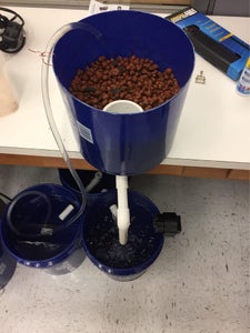

Place the fish, swirl filter, and sump pump buckets on the ground (maintaining the triangle formation). Place the plant bucket on a table that keeps the bucket about 2 feet above the other buckets.

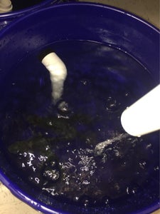

Step 11: Add Water
Add water into the fish bucket. Slowly do so until all of the surrounding buckets are filled about 2" from the top. (*There should not be any water in the plant bucket yet.)
Step 12: Creating Water Flow
Cut clear tubing to be about 3' long. Place one end in the bottom of the plant bucket. Connect the other end to the electronic water pump. Place the water pump in the bottom of the sump pump bucket. Connect the electronic pump to a power source.
Follow instructions of the water pump and turn it on.
The pump should suck water from the sump pump bucket into the plant bucket. The plant bucket should continue to fill up until the bell siphon activates.
Once the bell siphon is activated it should start pouring water into the fish bucket. This will remain a constant cycle of water flow through the buckets.

Step 14: Plant Seeds
Place clay pebbles in plant bucket. Fill it up about half way. Add cherry radish seeds into the pebbles. Move pebbles around to mix up seeds.
