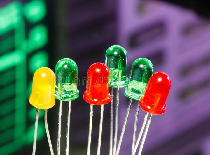

The only items you need for today's tutorial are the following:
  • Arduino (any)
  • USB type B
  • Some LEDs and resistors (between two-hundred and two-thousand ohms (3 LEDs and 3 resistors))
