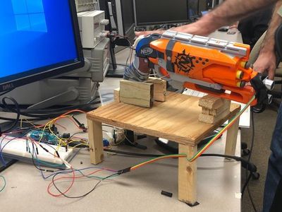

Step 1: Observe How the Schematic Above Is Labeled
Make sure that you observe the schematic properly. If you don't wire everything correctly, then you may cause a short to your circuit, which doesn't immediately damage your equipment, can do so over a period of time. The purpose of the schematic here is to show how the various components are wired so that your motor can properly function. The schematic was made using Fritzing, as well as sources from [5], [6], [8], for the battery, motor and relay respectively.
Step 2: Begin Wiring the 5 V and 12 V Sources.
Make sure that you wire the 5V and the 12V supply to different areas on the breadboard. This is to prevent any issues with wiring from happening in general. So, wire the 5V supply that the Arduino provides on one side of the breadboard, and wire the 12 V supply on the other side of the breadboard. There should be one positive terminal and one negative terminal for each of the voltage sources.

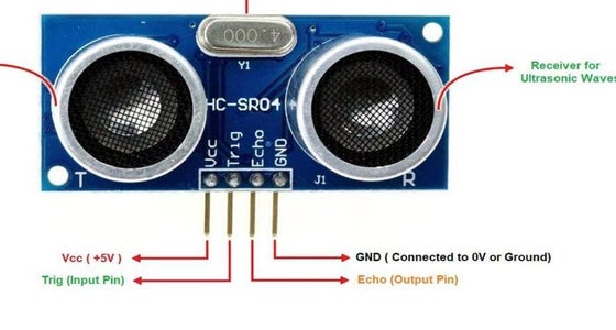

Step 3: Wire the Ultrasonic Sensor
The ultrasonic sensor has 4 inputs: The 5 V, the Ground, the Echo, and the Trigger. The 5V and Ground go on the 5V rails, Trigger goes on pin 13, and Echo goes on pin 12(of the Arduino). Picture was from [1].

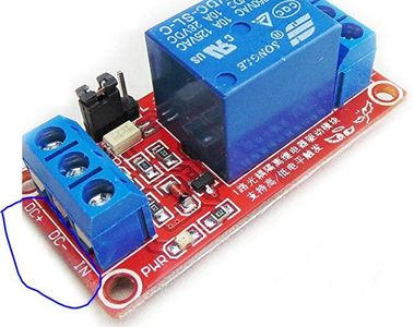

Step 4: Wire the 5V Side of the Relay Circuit
+DC goes to the 5V red rail, -DC goes to the 5V ground rail, and the IN goes to Pin 27 of the Arduino Mega. Translating from the picture to the actual relay, 5V is +DC, GND is -DC and S is Signal. Slightly different name, but the same concept. Note: You may have to unscrew and re-screw the wire holders in order to tightly make the connection. The picture was originally from [4].

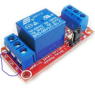

Step 5: Wire the 12V Side of the Relay
Wire NO to the 12V power source/battery, NC to the 12V ground, and COM to the DC Motor. Note, you may have to unscrew and rescrew each holder of the relay to tightly hold a wire. Picture was originally from [4].

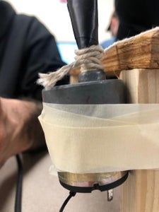

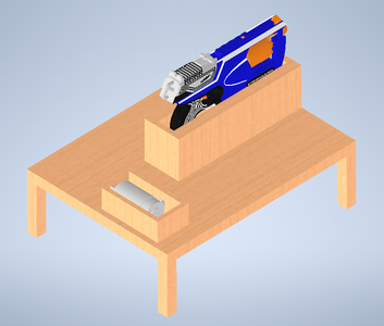

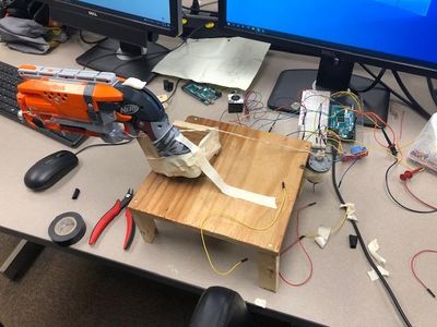

Step 7: Add the String to the Motor and Tape Everything Down
Be sure to add as much tape as you possibly can, in order to make your structure stable. Not enough tape can cause instability. Be sure to place the motor and the string next to the trigger of the Nerf Launcher so that when it gets activated, the sensor can push the trigger. The CAD Design on the right shows a general idea of how to tape everything. The motor has to be attached to the trigger via the string in order for the contraption to work. The CAD Design got inspiration from sources [9] and [10].
Step 8: Watch Your Prank in Action!
Have fun and watch your prank in action! We are not responsible for any type of injuries caused in the creation of this project, or the usage of this project. The prank in action is shown in the initial video of this step: Another video going more into depth about the Nerf Launcher is shown here: https://youtu.be/nHcXr0VXpjE
