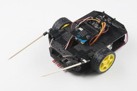

Step 1: Constructing the Micro:bot
In order to build the robot itself, click the link https://learn.sparkfun.com/tutorials/microbot-kit-experiment-guide/all#assembling-your-robot and follow the steps listed on the website. This process takes a while and can get quite dirty for your hands as the items in the kit leave this black residue! Wash your hands afterwards.
However, if you want the steps right now, here is an extremely condensed version:
  1. Attach both motors to the mounts.
  2. Attach the motor assemblies to the body.
  3. Attach the wheels to said motors.
  4. Install the accelerometers.
  5. Install the nub caster and the struts. Attach the top body on.
  6. Attach the Moto:Bit board.
  7. Wire the board.
  8. Install the batteries and leave them on the undertray of the car.
If you want more intricate details, then just click on the link above the steps.

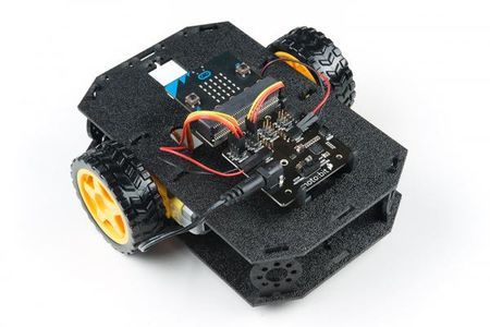

Step 3: Final Steps!
Now that you have finished coding, install the receiver Micro:Bit to the Moto:Bit board. Make sure that you install the correct Micro:Bit, or else it will not work. Connect the battery pack to the Moto:Bit board and turn on the motors. Make sure the other Micro:Bit (the transmitter) is also connected to power.
To drive forward, press the A and B buttons on the transmitter Micro:Bit at the same time. To turn left, press the A button on the transmitter Micro:Bit. To turn right, press the B button on the transmitter Micro:Bit. To turn stop the robot, flip the transmitter Micro:Bit upside down.
Congratulations! Your robot should be working!
