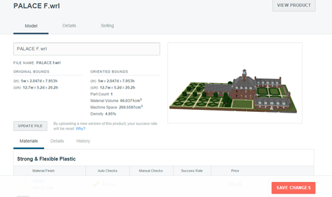

View your model

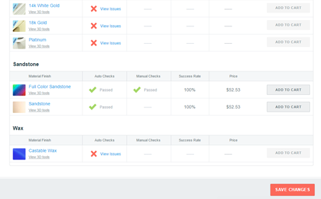

Shapeways will tell you which materials will work for your model. I used full color sandstone, which worked really well and kept a lot of the detail. Plus, I think it mimics the look and feel of Minecraft.
Add your model from your selected material to your cart and checkout
