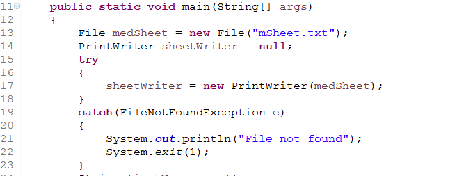

The first line of the program is where we create our file. By using a “File” object type, we create the file called “mSheet.txt”.

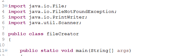

PrintWriter is the class we use to actually write to our file. Once we have created the PrintWriter object, we need to create a try catch instance. As you can see, the program “tries” to make sheetWriter a new PrintWriter for our file object. The catch is in place in case something goes wrong and the system needs to shut down, hence the “System.exit(1)”. You may notice that eclipse gives you an error even if you have typed this correctly. This means you need to import the File, PrintWriter, and FileNotFoundException functions into your java project. You’ll also need to import scanner for this program, so we’ll go ahead and do it now.
Make sure to place the import statements above public class so it works properly.

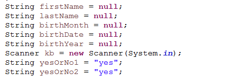

Now we begin creating variables for our program. We need to be able to record a person’s name and birth date so we make variables for the necessary information. Here we also create a Scanner object to record the data our user enters and store it in a variable. The yesOrNo variables will be used in an “if” statement and in a while loop.

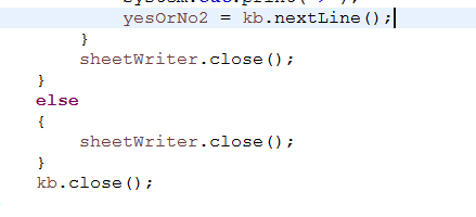

At the end of the loop we ask the user if they would like to stop or keep entering more information. The loop takes the user’s answer and determines if the loop will keep running. Outside of the loop we make sure to use the .close() function on sheetWriter to make sure there is no more processes running.

Finally, we write the “else” statement outside of the loop. This is the other half of the check performed by the “if” statement. If the user did not type “yes” at the beginning, they would be sent down to here. The statement simply closes the file writer just like the end of the while loop, but instead of performing any other actions, it simply closes the program. Outside of the else statement we must also close the keyboard variable.

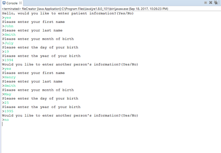

Above is a picture of console output demonstrating how your program should run if created properly. As you can see, the program will continue to ask the user for information until it is told “no”.

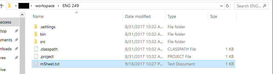

In order to find the file you created, you must go to your eclipse workspace and find the directory for your project.
Our file msheet.txt is here just as it should be. Upon inspection, it has all of the patient info that we recorded.
