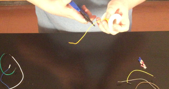

Step 2: Stripping Wires
To begin you'll want to take roughly 6 inches of solid core wire and cut it from your spool, then strip about 1 inch off the end, precision doesn't really matter so take a bit more than you need, remember you can always make the wire shorter, but you can't make it longer. After you're done with the solid core wire, take one of the male to female jumper wires and carefully remove the male end (the end with the wire coming out of it) and carefully pull it off. Be aware that since this wire is braided core it can be easily snapped or ripped.

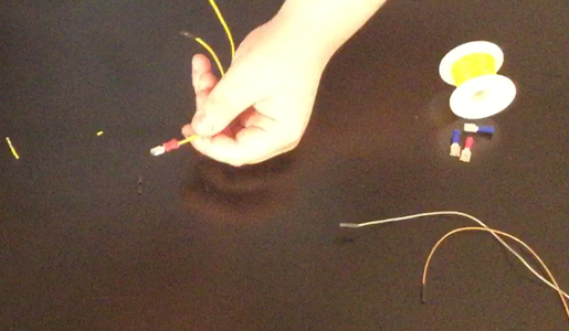

Step 3: Using the Female Quick Connect to Crimp the Wires Together
You'll want to insert the stripped end of the solid core wire into the barrel of the quick disconnect then do the same with the exposed end of the jumper wire, you can twirl the exposed braided core wire around the exposed solid core wire to ensure they are connected when you insert them into the barrel. Once you've inserted them into the barrel make sure they aren't protruding from the exposed end of the quick disconnect. Once you've done this, find the colored crimper on the crimping tool that matches the color of the insulation on your quick disconnect, then crimp it 2 to 3 times to ensure it doesn't fall out. Then strip 1 inch off the other end of the solid core wire and insert it into the barrel of another female quick disconnect and crimp it 2 to 3 times.

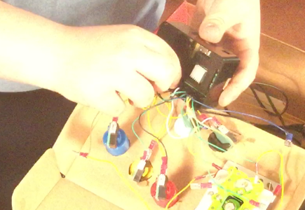

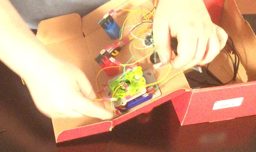

Step 4: Connecting the Raspberry Pie to the Joystick or Buttons
Once you've crimped the wires together, take the female end of the jumper wires and plug it in to the GPIO board on the Raspberry Pie (The part with the male connectors) and take the second quick disconnect and plug it into the male quick connect on your Joystick or Button. Congratulations, you have successfully connected a Raspberry Pie and a Joystick or Button together.
