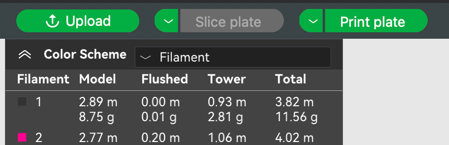

You Should see a green bar on the right side of your screen.
Press or move the top ball to where you want to change a new filament.
For AMS
Right click the same place and choose "Change Filament" and pick the next filament you want to use.
For No AMS
Right click the same place and press add pause.
Step 5: Re Slice
Once you are done picking all your colors, click slice again, look at your model and press PRINT PLATE.
Step 6: Print.
Pick your printer and the check / correct the corresponding colors.
