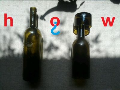

Step 1: The Victim
to be guillotined: a glass-bottle from the trash.
__btw 1, this works not just on round objects
__btw 2, the following cut is done without any scoring of the glass (see a future-post on that)

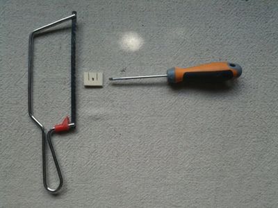

so here i opt for a little piece of (ply)wood from a fruit-crate; quickly customized as follows:
_1 make a (square or rectancular) small hole - (i just use a screw-driver and punch it through the wood).. through this hole the two ends of the wire-loop will come out , very close to each other b u t not touching
_2 to create some kind of lock of the wire-ends i just make two cuts on each side of the center-hole (see picture - i used any small saw that was flying about up here in the cabin)... the ends of the loop coming out of the hole will just be snaked through the slits (this, friction, helps tighten the loop around the body to be cut, as well as prevents loosening - just think of it as a simple ´belt´)

moment of truth 1: i applied about 180v for about 20 seconds
then, right away, get ready for some:
Step 4: Shock
your wiring quickly unplugged or switched off from the main-source:
comes the moment of truth #2: just dip the bottle with (again, d e a d ! ) wires in some receptacle containing cold water you have prepared sitting on the side.
the bottle will snap (thermo-stress) along the wire-trace (not even having been scored)
..... done
