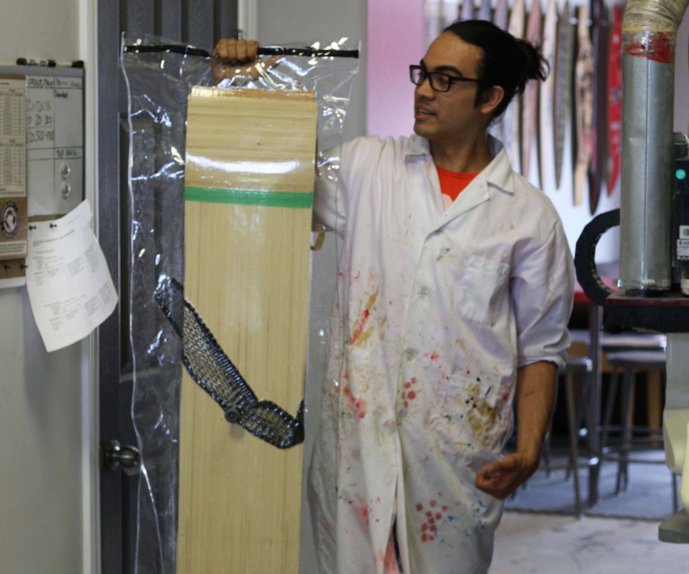

To grip such a unique handmade longboard, we needed something more than just the average solid grip tape job on the top side of the deck. We decided to cut out a small design that would let the natural maple veneer show through the grip itself. Sticking with the 'dancer' theme, we found a silhouette image of a ball room dancer in a top hat for our design.
We cut a length of grip tape at 20" long to apply our image to. This will end up in the middle of the deck and is a nice short piece to work with.
After taping our image to the back (paper) side of the grip tape, we start cutting out the areas we want the wood to show through.
**Remember to mirror (or flip) your image before printing if you want it to align a certain way on the grip. Because you are cutting your image from the back side of the grip, any image will show up in the reverse once it has been applied to the deck. This is especially important if you have any text you want to cut out.
Step 2: Cut Design
Cutting from the back side of the grip tape is always easier than from the front side. It may take a bit more thinking to visualize what it will look like in the end, but it is much quicker to cut and won't dull your knife as quickly as cutting the rough top side of the grip.
Using the printed image as a guide, we were able to cut out this simple design in about 10 minutes with the utility knife. Grip tape art can get pretty intricate if you want it to be, so taking your time with the knife during this step is important.
Make sure to keep any interior pieces that you may need to cut out and stick later. For example, the inside of the letter 'O' or 'A'
Step 3: Stick Grip
Peel the paper backing off of the grip tape, and carefully stick the sheets in place on the deck. Grip tape is quite tacky, so it can be difficult to re-position a piece if it gets stuck in the wrong spot.
When laying down the areas of grip that are intricately cut out, be extra careful when peeling and sticking those parts to make sure they are in the right position and do not rip.
TIP: If you still have the offcuts from the design you cut out from the grip, you can use these sections to make sure your image is properly positioned. Simply lay the offcut piece in the open area of grip, and check to see if it lines up. You can also use this trick to help position those interior pieces that need to stuck down to complete the image. ***See image notes
