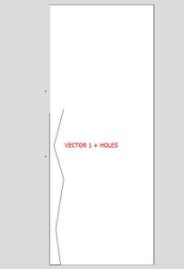

Step 1: Add Locating Holes and Split Your Drawing

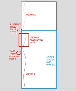

In your CAD program add the Locating Holes along the Y axis as in the second picture. The second hole should be near the end of the working area and they should be as far apart as possible (for better accuracy with aligning with Y axis). The coordinates shown apply to my CNC router, which has a working area of 480x 800mm.
Next, split your drawing into two pieces making sure they are overlapping each other (you can extend the vectors to do that). Each of the pieces must be smaller than the working area of your router.

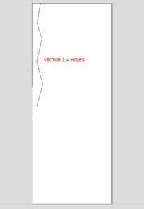

Step 2: Re Position the Second Half of Your Drawing
Generate the toolpaths for the first half of your drawing and the locating holes.

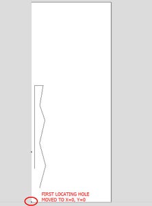

Highlight the second half of your drawing and the holes and bring the centre of the first hole to X0 Y0 as pictured above. The holes and the second half of the drawing should remain in the same position in relation to each other.
Generate the toolpaths for the second half of your drawing, you can ignore the holes this time. Make sure the toolpaths are on the correct side of the vector - some programs may get confused while calculating toolpaths for open vectors.

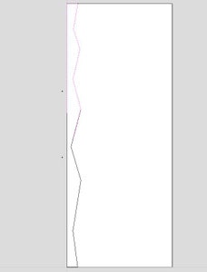

Step 4: Reposition the Stock and Align the Stock With Y Axis
Reposition the stock so that the first hole (marked blue) is near the Y0 of your router, as in the first picture.
Manually jog the router along the Y axis ONLY to reach the second hole. move the stock carefully to align the second hole with the endmill whilst making sure the first hole stays in the same place.
Jog the router back along the Y axis ONLY to the first hole and if the cutter is exactly above the hole, reset both axes to 0 (x=0, Y=0). Otherwise repeat this step.
