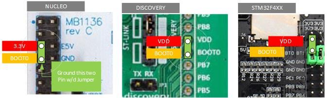

Step 1: Hard-wiring / DFU DfuSe / Bootloading STM32 / ARM
Note: These following boards below are not officially supported but should be fully running and functional.
DFU or DfuSe is a package for the firmware upgrade on STM32 chip system memory via USB DFU contains a debugging GUI also the source file, and protocol layer. The advantage of DFU bootloading is you don’t need a JTAG, ST-LINK, and you can flash and upgrade an empty STM32 device in a newly-assembled development board via USB to UART. There are several software that we can use to DfuSe STM32 system memory run on Windows, Mac, and Linux environment, for windows you can use STMicroelectronics STSW-STM32080, and for Linux & Mac dfu-util To DfuSe an STM32 / ARM you need to place a jumper from VCC to BOOT0 pin which is some of the STM32 boards are not indicated on this case you need to see the schematics diagram of the STM32 development boards or the datasheet of the microcontroller.
