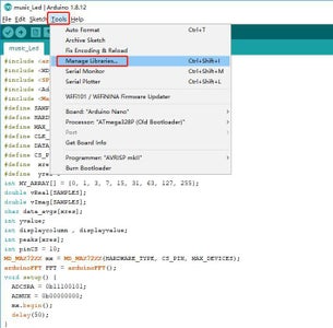

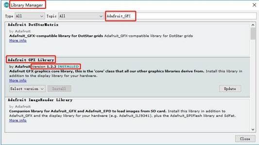

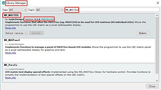

1. Install Library file: Open "Tools"-"Library Manager" in the Arduino development software, then search for arduinoFFT, MD_MAX72xx and Adafruit_GFX, then install them.

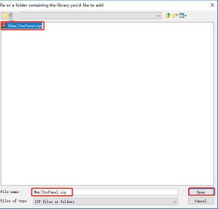

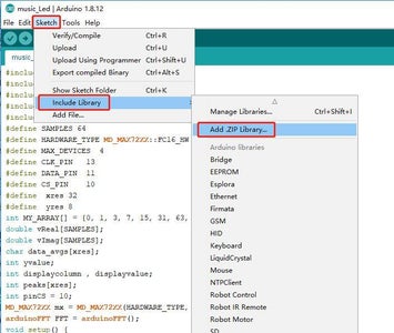

2. Install Library file: Open "Sketch"- "Include Library"-"Add .ZIP Library……" in the Arduino development software, then add Max72Panel.zip

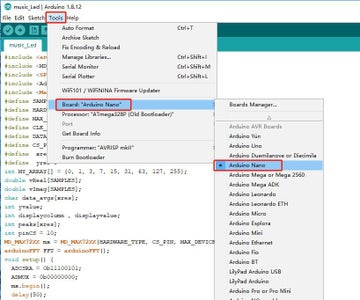

3. Select the development board as Arduino Nano, this is choose the right.

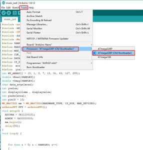

4. Select the processor as ATmega328P(Old Bootloader), this is to choose the right.

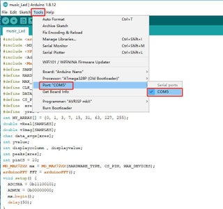

5. Then select the port, this port should be the same as what you see in the device manager, so that you can burn the code into the development board.
