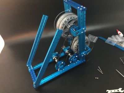

Assemble the friction wheels
Don't forget to attach the timing belt to the right timing pulley. The 240MXL (the longer one) is on the top, and the 132MXL (the shorter one) is on the bottom.
Step 9:
Then mount the beam-2424 to the frame. more
Step 10:
Complete the whole frame.

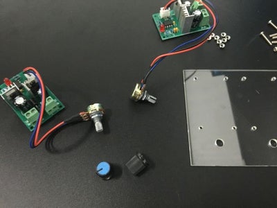

Mount the motor drivers to the acrylic
sheet
Required parts:
2 x Motor driver
1 x acrylic sheet
8 x Nut M3
8 x Screw M3

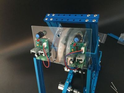

Step 17:
Complete the triangle structure
Required parts:
2 x Beam0824-320
4 x Lock nut M4
2 x Screw M4x22
2 x Screw M4x35 Fix one end of beam-0824,
put the acrylic sheet into the slots, and fix the other end of beam-0824.
You may need a helper to hold the frame while you are trying to fix the second end of beam-0824.

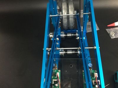

Step 18:
The slide rail
Required parts:
2 x Beam0808-312
2 x Bracket P1
1 x plate 45°
4 x Screw M4x8
Step 19:
Mount the slide rail to the frame
Required parts:
2 x Shaft D4x160
12 x Shaft collar 4mm
12 x set screw m3x5
2 x plate 45°
2 x Lock nut M4
2 x Screw M4x16
Step 20:
