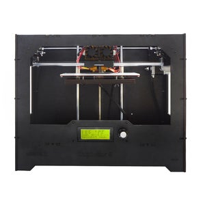

Step 1: Meet the Duplicator 5 3D Printer

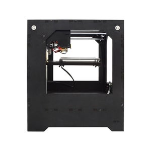

In this chapter, an introduction to the main frame of Duplicator 5 is made to get you to have an in-depth knowledge of 3D printer. At first, please prepare all the panels by attaching the necessary parts. Secondly, assemble the main frame. Finally, attach other important parts of Duplicator 5 on the main frame.
Before we start, let’s get familiar with the panels of the Duplicator 5 3D printer.

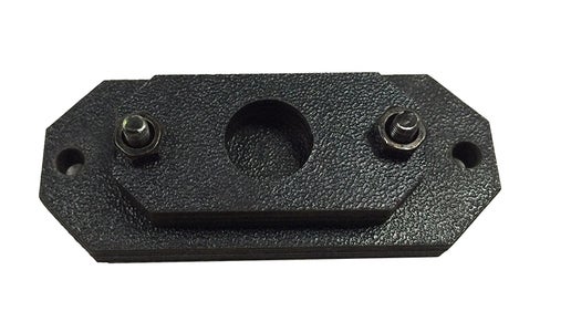

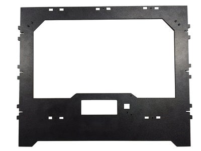

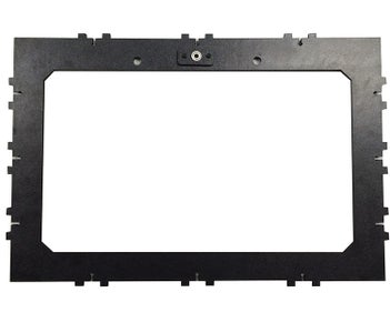

Step 2: Prepare Front Panel
Required parts Required number Part ID
Front panel x1 NO.D1
Y axis rod fixed panel x 2 NO.D10
M3*16mm Screw x 4 NO.17
Hex nut x 4 NO.11
Take the front panel. Attach 2 Y axis rod fixed panels to the inside of the front panel with 4xM3*16mm screws and 4xM3 hex nuts.
Note: Please pay attention to the direction of the holes on the fixed panels.

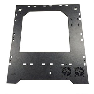

Step 3: Right Side Panel
Right side panel x1 NO. D2
Ball bearing x2 NO. 28
Stepper motor x1 NO. 51
M3*12mm Screw x4 NO. 16
M3*20mm Screw x 8 NO. 18
Hex nut x8 NO.11
M3 Washer x12 NO. 5
Motor gasket x1 NO. 38
Pulley x1 NO. 31
Fan x2 NO. 53

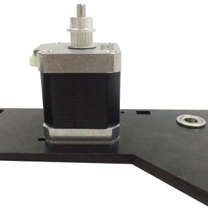

Step 1. Take the right side panel and Insert
2 ball bearings into the corresponding holes on the top of the panel.

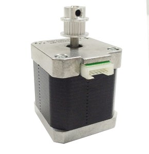

Step 2. Attach the Y axis stepper motor to the inside of the panel with 4xM3*12mm screws, 4x M3 washers and the motor gasket.
Step3. Fix the Y axis pulley on the axis of the stepper motor with a set screw. (with the threaded part attached to the stepper motor)
Step 4. Attach the two fans to the lower
right of the panel with 8xM3*20mm screws, 8 washers and 8xM3 hex nuts. Please make sure that the fans are on the inside of the panel.

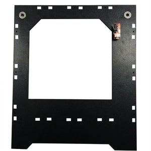

Step 4: Left Side Panel
Left side panel 1 NO. D4
Ball bearing*2 NO. 28
Endstop*1 NO. 40
Spacer *2 NO. 36
M3*25mm Screw*2 NO. 19
Hex nut*2 NO. 11
M3 Washer*2 NO. 5
Step1. Take the left side panel and Insert 2 ball bearings into its corresponding holes.

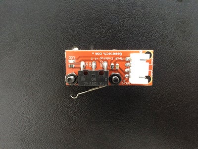

Step 2. Attach the Y axis endstop to the inside of the panel with 2 spacers, 2x M3*25mm screws, 2xM3 hex nuts and 2 x M3washers.

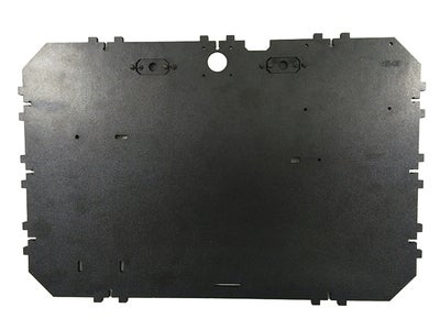

Step 5: Lower Panel
The lower panel*1 NO. D6
Z axis rod fixed panel*2 NO. D8
Z axis rod holder *2 NO. D9
M3*16mm Screw*8 NO. 17
Hex nut*8 NO. 11
Step 1. Attach the Z axis rod fixed panel (1 piece) and Z axis rod holder (1 piece) together with 2xM3*16mm screws and 2xM3 hex nuts.
Apply this assembly method to the other two panels.
Note: With the Z axis rod fixed panel (with a hole on it) on top of the Z axis rod holder.
Step 2: Fix the above assembled parts on the bottom of the lower panel with 4xM3*16mm screws and 4xM3 hex nuts.

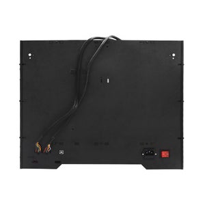

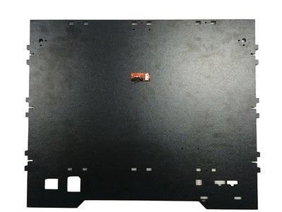

Step 6: Rear Panel
Rear panel*1 NO. D3
Endstop*1 NO. 40
M3*16mm Screw*2 NO. 17
Hex nut*2 NO.11
M3 Washer*2 NO. 5
Take the rear panel and attach the endstop on the inside of the panel with 2xM3*16mm screws, 2xM3 hex nuts and 2x M3 washers.
Note: Fix the endstop tightly and avoid any inclining.
