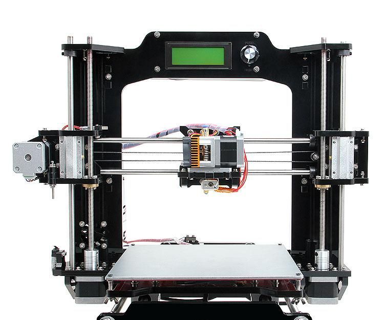

This instructable is for the whole building process of Geeetech Duplicator 5 DIY dual extruder 3D Printer
You can use the building instruction manual with the video for detailed parts No. and required qty.
Please download the manual here:
https://www.geeetech.com/geeetech-wood-duplicator-5-diy-dual-extruder-3d-printer-p-1016.html
watch the whole playlist here: https://www.youtube.com/playlist?list=PLODCkot3GriggeiHt4KxRsgxX2igi8jQ-
Step 1: Assemble the Building Platform

Step 2: Assemble X Axis
Required parts Required number Part ID
Stepper motor*1 NO. 50
Pulley *2 NO. 31
Linear bearing* 8 NO. 26
Extruder carriage*1 NO. P3
Driving wheel carriage*1 NO. P1
Driven wheel carriage*1 NO. P2
X axis rod *2 NO. 2
Ball bearing*2 NO. 27
Driven wheel shaft*1 NO. 30
Endstop*1 NO. 40
M3*8mm Screw*4 NO. 15
M3 Washer*4 NO. 5
Step 1. Assemble the driving wheel carriage.

Step 5: Assemble Z Axis
Z axis rod *2 NO. 4
Locking ring*2 NO. 7
Ball bearing*1 NO. 29
Z axis threaded rod *1 NO. 52
M3*12mm screw*4 NO. 16
M3 Washer*4 NO. 5
Step 1. Respectively fit the two Z axis rods into the two corresponding holes on the upper panel, two locking rings, the two linear bearings on the hotbed from the top down, until they reach the Z axis rod holder on the lower panel. Fasten the locking rings.
Step 2. Insert the Z axis threaded rod spirally from the bottom up into the corresponding hole on the lower panel, through the Z axis nut on the hotbed and a ball bearing, until the threaded rod reaches the Z axis bearing fixed panel on the upper panel.
Step 3. Fix the motor tightly with 4xM3*12mm screws and 4 washers. (Fasten the screws in a diagonal direction.)
