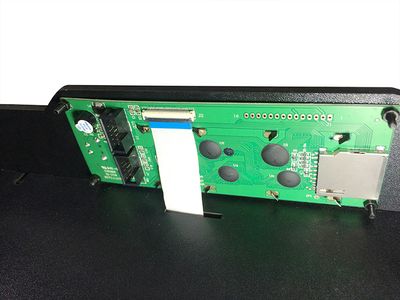

Step 2: Mount the LCD Control Panel
Required parts Required number Part ID
LCD 2004 *1 NO. 45
Knob *1 NO. 46
M3*16mm Screw *4 NO. 17
Hex nut *4 NO. 11
M3 Washer *4 NO. 5
Step 1. Connect the LCD cable with the port on the back of LCD control panel. Thread the wire through the corresponding rectangular hole on the lower panel.
Step 2. Attach the LCD control panel to the inside of the front panel with 4xM3*16mm, 4xM3 hex nut and 4xM3 washers. (Tighten the screws in a diagonal direction.)
Step 3. Loosen the knob screws slightly. Fit the knob with the screw attached to the flat part of the metal handle, and tighten the screw.

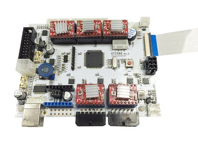

Step 4: Mount the Control Board
Control board 1 NO. 41
Spacer 4 NO. 37
Heat sink 5 NO. 42
Sticker 2 NO. 43
M3*16mm Screw 4 NO. 17
M3 Washer 4 NO. 5
Step1. Cut5 rectangular scraps of the stick according to the size of the heat sink. Stick the 5 scraps to 5 heat sinks orderly. Subsequently, attach the heat sinks to 5 A4988 chips respectively.
Step 2. Insert 4 spacers into the 4 corresponding corners on the control board.
Step 3. Fit the protruding side of the control board into the sinks on the lower left part of the rear panel. Mount the control board on the bottom of the lower panel with 4xM3*16mm screws and 4xM3 washer.
Step 4. Connect the control board with power supply unit. Please distinguish the anode wire from the cathode one (red-anode, black-cathode).
