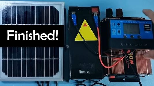

Let’s start building your very own portable solar generator!

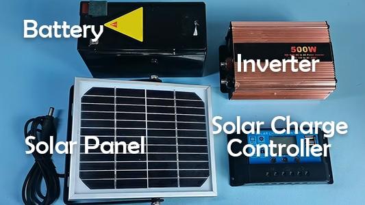

Materials List:
  1. 1 × Solar Panel (12V, at least 50W recommended)
  2. 1 × Solar Charge Controller
  3. 1 × 12V Rechargeable Battery (Lead Acid or LiFePO4)
  4. 1 × Inverter (DC to AC, 300W or higher)
  5. Red and black wires
  6. Wire connectors / crimp terminals
  7. Electrical tape
  8. Fuse (10A–20A inline fuse recommended)
  9. A sturdy box or enclosure to mount everything

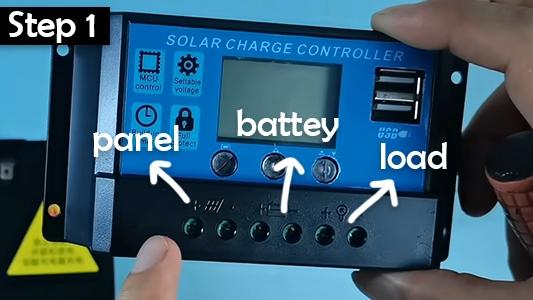

Step 1: Understand the Solar Charge Controller
Most controllers have 6 terminals:
  1. Left 2: For connecting to the solar panel
  2. Middle 2: For the battery
  3. Right 2: For the load (inverter, USB, etc.)
Label or color-code your wires:
  1. 🔴 Red = Positive
  2. ⚫ Black = Negative

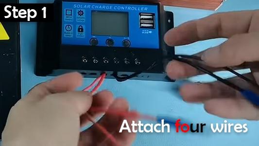

Step 2: Connect the Battery to the Charge Controller
Important: Always connect the battery first before the solar panel.
  1. Connect the red wire to the positive battery terminal, and insert it into the middle-left terminal of the controller.
  2. Connect the black wire to the negative terminal and the middle-right terminal of the controller.
  3. Tighten screws on the terminals.
Once connected, the charge controller screen should light up, showing battery voltage.

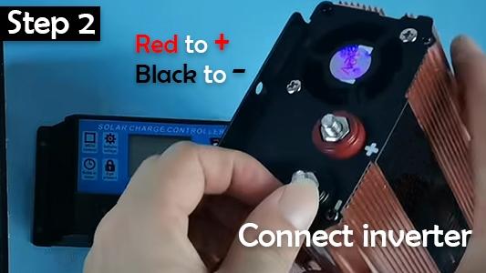

Step 3: Wire the Inverter to the Battery
  1. Connect the red wire from the inverter to the battery’s positive terminal.
  2. Connect the black wire to the battery’s negative terminal.
  3. Secure both with ring terminals or heavy-duty clamps.
  4. Turn on the inverter to check for power-up.
💡 Tip: Add an inline fuse between inverter and battery for safety.

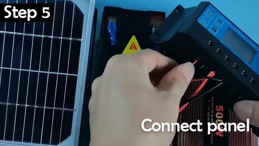

Step 4: Connect the Solar Panel
  1. Take the wires from the solar panel, and connect them to the left two terminals on the charge controller.
  2. Positive to positive (red), negative to negative (black).
  3. Place the solar panel in full sunlight for testing.
The controller display should now show the charging symbol or an LED light blinking.
Step 5: Power Up Your Devices
  1. Plug a USB charger, LED bulb, or small device into the inverter.
  2. Flip the inverter switch ON — if everything is working, the inverter should supply 110V or 220V AC power.
Try charging a phone, powering a fan, or even running a small radio.
