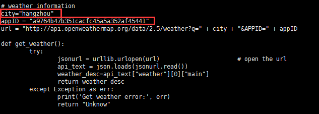

Step 5: Change the Code
You can change it as you wish, such as thunder sound, the rain sound, etc. You should put audio file into audio folder in advance and add the content in the red box below into the code.(image 1)
In this application, we get the data from OpenWeatherMap.org, where you can get your own appID. And if you need to switch to another city, modify the info in the following red box(image 2)

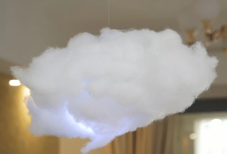

Step 8: Make the Cloud
Use a glue gun to stick the cotton to the wire.(image 1)
Tie up the top with a fish line, which will be used to hang the cloud to the rooftop. Please remember to hide the ReSpeaker module and the power within the cloud.(image2)
Step 9: Done
Voila! Now we have an interactive cloud, which can interact with you through sounds. Welcome to try and add some other interesting features as you like. You can make a cloud that can blow winds or a cloud that pours rains etc. The sky is not the limit! Don't forget to share your cool projects with us!
