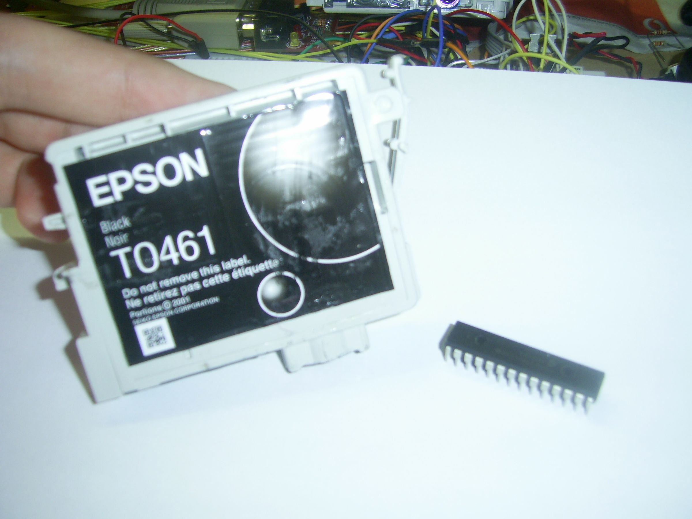

Okay well, I have just started to get into SMD soldering and always wanted to scavenge components from other circuit board that I have lying around. recent I pulled apart an old printer and found that most of the ICs on it had their data sheets publicly available and thought to myself maybe I could use that in my next project.
The problem is that i had no way of removing the component without destroying the chip using conventional de-soldering techniques with my good and trusty soldering iron.
So after a while I decided to try and remove the component using a butane gas torch, and would you know it, it was a complete success!
So now I'm going to share with you what i found.
