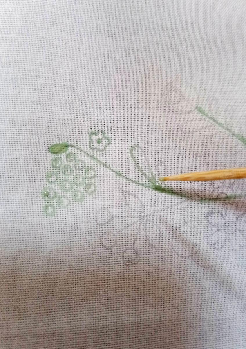

Get really thin brushes and at least two of them, if you want to not only stamps but also paint. You can also paint with a toothpick, wooden stick with a point or a pointy plastic tube with small opening. Brushes work best for me though.

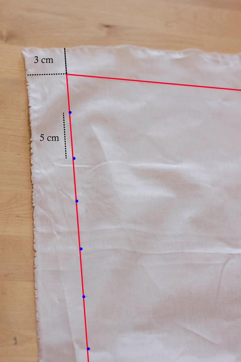

- If you want to use small stamps like I did or paint small regular shapes, you need to make some guide frame. The workshop recommends to leave 3 cm/1.18 in around all edges free, so I measured and made a line at this distance from the edge on all four sides of the fabric (red line in the photo). I actually used these 3cm edges to test some of my stamps.
- I decided to apply the stamps at 5 cm/2 in distance, so I measured points 5 cm from each other along both long sides of the fabric (blue dots in the photo). I didn’t connect them and I’ll use a long ruler as a guide later.

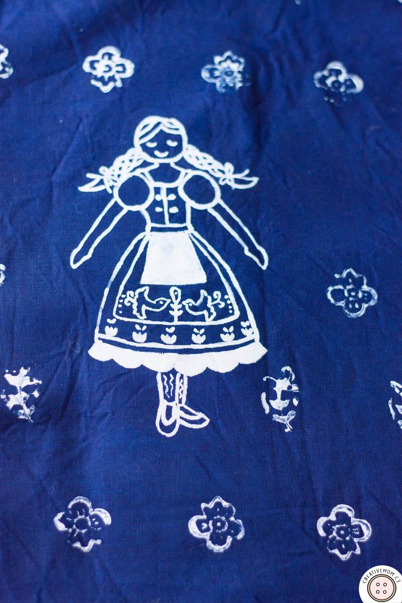

- In the second photo, you can see a traditional stamped design.

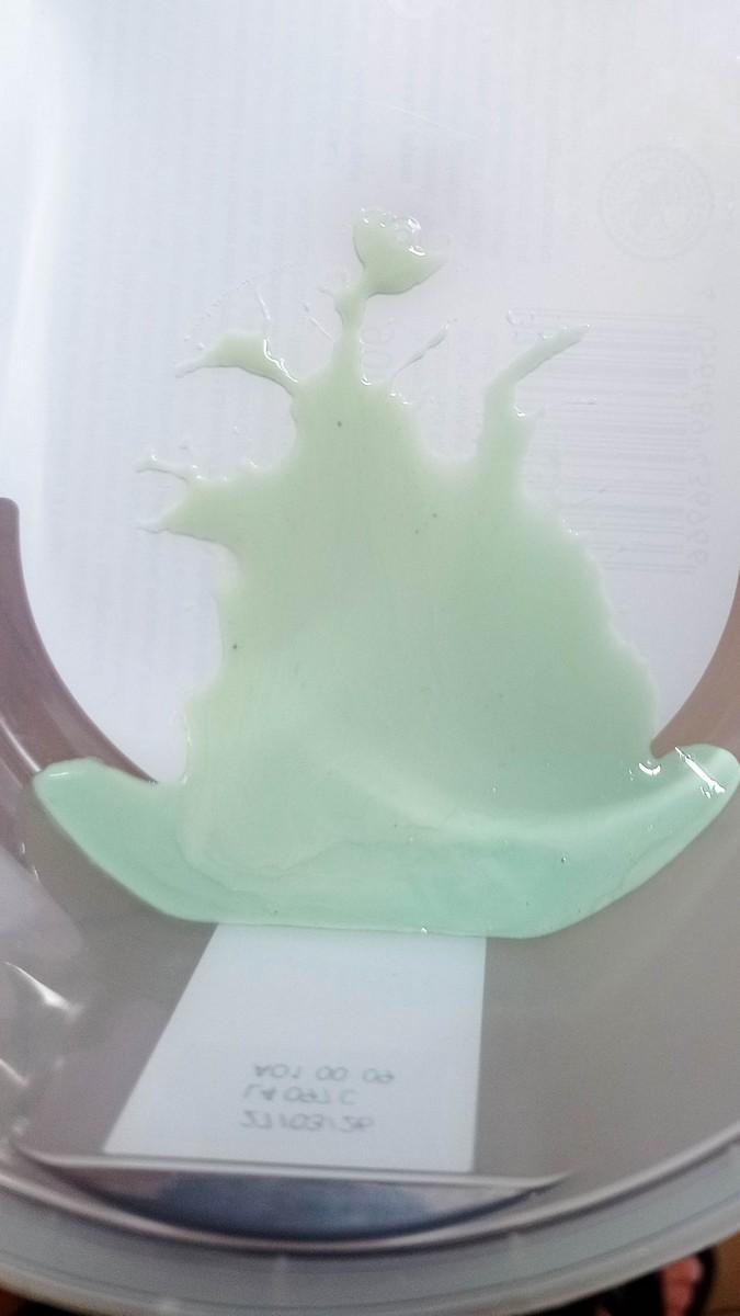

- Before you start, make sure to mix the reserve properly. I find shaking the bottle does the job. If I pour the reserve first and then mix it with a brush, there are always traces of darker green, whilst properly mixed reserve is light green. In the picture, you can see the nicely unified light green in the upper part of the reserve and the dark green traces in the lower part.
- The reserve can be thinned down with water but whenever I mixed in just a few drops of water, the reserve would become too liquid and the pattern would blur. Pour just a little reserve in the container, it thickens after some time. I don’t thin it with water even then.

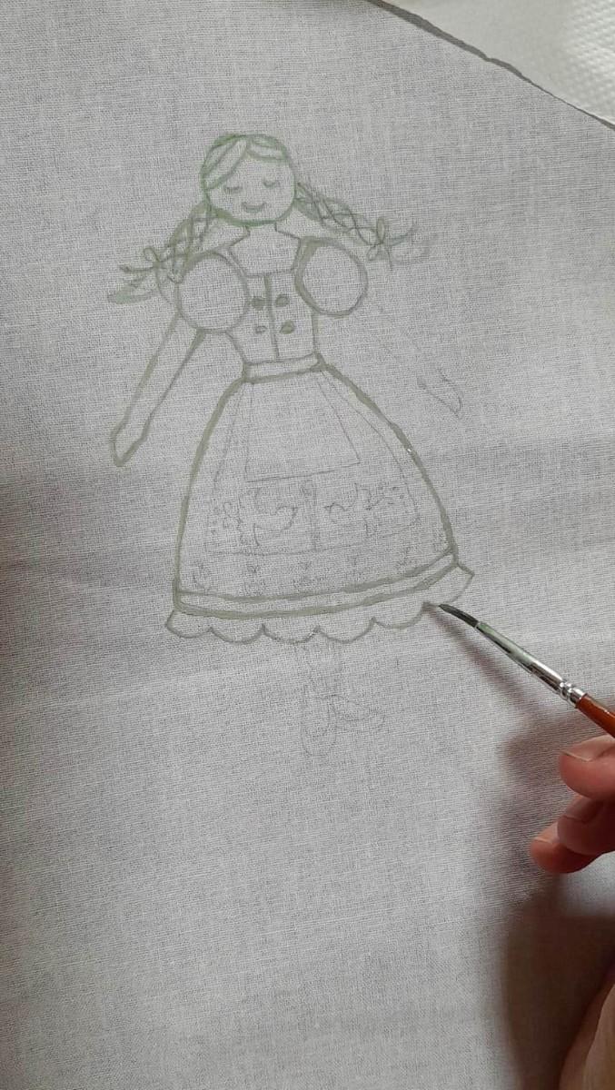

- I dip just the tip of the brush and I wipe it often to prevent large drops of reserve. Next time, I will use even thinner brushes though.
- I tried painting with a pointy wooden stick – it’s good for making tiny dots but I not so much for lines.
- After I was finished painting the ornaments, I let them dry properly.

Insufficiently mixed reserve
I was painting my third ornament when I realized the reserve wasn’t mixed well. The liquid in the container had dark green traces in it instead of being all light green and the dry reserve on the ornaments wasn’t unified in color. Solution? Paint everything again. I also discovered that shaking the bottle works better than mixing the reserve after I pour it.

Step 8: Results With Different Types of Stamps
I have already shown you some painted ornaments, here are some examples of the use of different types of stamps.
Photos 1 - 2: foam stamps
Photo 3: foam and wooden stamps
Photos 4 - 5: wooden stamps
Photo 6: combination of painted names and wooden stamps
