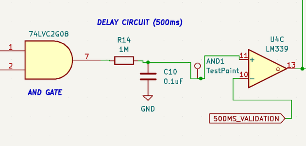

Proceeding ahead the BSPD triggers when the 2 conditions are active at the same time so for this we need to use an AND logic gate for verifying if both the conditions are met. For checking if this signal is free from errors and is not resulted high from any external interference we need to add a 500ms plausibility check circuit which can simply be executed with a delay circuit.
We must keep in mind that the BSPD circuit is a nonprogrammable circuit which means we cannot use any microcontroller etc for the 500ms check.
The delay circuit consists of a RC network in which depending on resistors value the time required to charge the capacitor to almost 99% of the input voltage. This time delay helps to verify if the conditions are present for more than the threshold and are non erroneous signals.

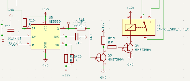

After we verify that the signal is genuine we send it to the 555 timer circuit(Monostable mode) which will perform the job of opening the shutdown circuit for 10sec by actuating the relay.

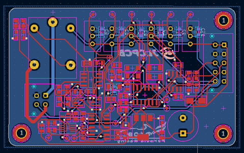

After we designed our schematic we then designed out PCB layout followed by generating our gerber files.
After finalising all of our designs we sent them to JLC PCB for manufacturing.
We assembled the boards and the BSPD worked well every time we needed it.
