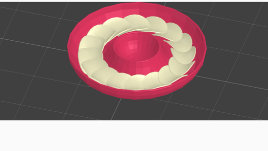

Once you’ve launched the editor;
From the 3D Shapes category on the toolbar choose torus; set tube radius to 25, tubular segments to 20
Tick the checkmark to finalize torus
From the right panel choose cube selection; Set bottom to 25
Click to finalize cube selection
Click delete button to delete selected objects
From the 3D Shapes category on the toolbar choose sphere; Set radius to 25, horizontal segments to 24
Tick the checkmark to finalize sphere
Click to finalize cube selection and click delete button to delete selected objects
Click highlighted part on selection cube to turn off region selection; click on mesh 4 to select it
From the utilities category choose combine; Set method to merge
Click to finalize combine
From the modify category on the toolbar choose add thickness; Set thickness to -2., use vertex normals to true
Tick the checkmark to finalize add thickness
Click to activate edge selection; Click selection settings button to change selection settings; set loop selection to true, click on highlighted edge to select loop from the object.
Click ‘x’ to close selection settings panel
From the modify category on the toolbar choose fillet; Set intensity to 3.4, level to 6.
Tick the checkmark to finalize fillet
From the modify category on the toolbar choose fillet; Set intensity to 1, level to 3.
From the 3D Shapes category on the toolbar choose cylinder; Set top radius to 15, Bottom radius to 15, height to 1, position x to 50, position y to 10.
Tick the checkmark to finalize cylinder
Click scale on the toolbar; Set z to 40
Click ‘x’ to close transformation panel
From the modify category on the toolbar choose resolution; Set detail level to 5
Click to finalize resolution
From the deform category on the toolbar choose bend; Set dynamic origin to true, plane to left/right, y to 100, plane to back/front, y to -50
Click rotate on the toolbar; Set x to 16
From the tools category on the toolbar choose copy offsets; Set operation to pivot, amount of copies to 15, click copy button to create copies.
Click ‘x’ to close copy offsets panel
From the edit menu on the top toolbar choose group; Click color picker button to change color of object; Click beige
Click ok
Click on mesh 4 to select it. Click on group 1 to select
Click color picker button to change color of object; Click red
Click ok
