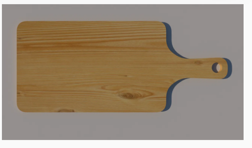

Once you’ve launched the editor;
From the view menu on the top toolbar click reference image to add reference image ; Click add image button to load new image
Click load image from tutorial button to add image
Set opacity to 50
Click ‘x’ to close reference image panel
From the Drawing category on the toolbar under 3D Sketch, choose Rectangle
Set Minimum angle step to true
Click on highlighted point to draw Rectangle
From the tool panel choose circle
Click on highlighted point to draw Circle
Type in 7 value into the Radius measurement
Click ‘x’ to close 3D Sketch panel
Click to activate Edge selection; Click on highlighted region to select it
Click Delete button to delete selected object
Click Scale on the Toolbar; Set x to 30
Click ‘x’ to close Transformation panel and click on highlighted region to deselect it
From the Modify category on the Toolbar choose Edit Details; Set part of Geometry to vertex
Click on highlighted point to add vertex to the selected object
Tick the checkmark to finalize Edit details
Click to activate vertex selection; Click on highlighted region to select it
Click on highlighted region to deselect it
Set x to 25
Click ‘x’ to close Transformation panel and Click on highlighted region to deselect it
From the Modify category on the Toolbar choose Fillet; Set Level to 5
Tick the checkmark to finalize Fillet
From the Modify category on the Toolbar choose Extrusion
Tick the checkmark to finalize Extrusion
Click highlighted part on selection cube to turn off region selection
From the right panel choose Materials
Set settings to textures, Set texture category to Wood and Click Wood 1 button to apply texture
Tick the check mark to finalize materials
From the view menu on the Top toolbar click reference image to add reference image; Click Remove button to remove reference image
