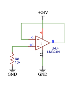

Step 6: Unused Amplifiers
In the circuit, only three out of four available amplifiers are used. To avoid the risk of oscillations and instability, best practice suggests not to leave unused amplifier unconnected. The picture shows how to safely connect the unused amplifier.
