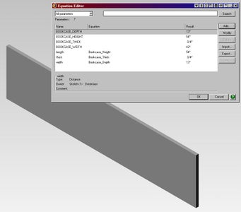

Open the Equation Editor - f(x) - and select the Add option.
We are going to add Parameters for the overall size of the bookcase, that will drive the rest of the bookcase part Dimensions. While this is a bit of an overkill for such a straight forward design, it will demonstrate how the use of equations and parametric modeling can be applied to more complex designs.
Parameter Names must not contain spaces and very few special characters are allowed, so I will use an underscore as a separator. We like to work with mixed Case parameter names, Capitalizing the first letter of a word and use the underscore separator between the descriptive name and dimensions indicator (e.g. Length, Thick, Width, Offset). However, in order to highlight the parameters that provide the overall dimensions of a design, we like to fully capitalize the entire parameter name. While it is a bit harder to read, it makes these important values stand out from the rest of the working parameters. It also helps the user quickly identify what parameters should be changed to modify the design conditions for the current model. When using those fully capitalized parameters in equations, they should not be capitalized! This avoids the necessity of having to change the capitalization of a large number of parameters should the design evolve and different parameters become the all important design specifying parameters. Capitalization is irrelevant within equations, and has evolved in our use to bring attention to specific parameters.
Open the Equation Editor, and select the Add button to manually add new parameters to the Equation Editor. Enter BOOKCASE_HEIGHT for the parameter name, and 54" for the Equation value; BOOKCASE_WIDTH and 42" for the breadth, er... Width; BOOKCASE_DEPTH and 13" for the depth; and BOOKCASE_THICK and 3/4" for the thickness of the components parts for the bookcase. We just need to add BOOKCASE_TOEHEIGHT and 3" to define the height of the toe kick below the bottom shelf. With these 5 parameters that define the overall design conditions of the bookcase, we now have all the information we need to create equations that will specify the size of each part.

Zoom way out and select Activate 2D Sketch on the XY plane. We are going to start with the side of our Bookcase. We could start with any part, but have chosen the side as the best part to begin the introduction on using parameters with equations.
Draw a rectangle, constrain it symmetrically about the X & Y axes, and get ready to dimension the Width and Length. Review the Instructable "Model Woodworking Board or Sheet Part" if you need more detailed information on the steps to draw a simple board. Read it carefully, because it is crammed with everything you need to know in order to construct a board model that will function properly all the way through output for drawing, Bill of Material, and sheet nesting or even CNC machining. Since the focus of this lesson is parametric dimensioning, we will concentrate on the dimensioning aspects of this board part.
Add dimensions. We know that the bookcase is 54 inches high. It would be safe to presume then that the side will be 54" long, and we would be right. It would also be safe to say that any drafting program can do this. Since we are using Alibre and it has the advantage of being parametric, we want instead to set the value of the part Length to the (you guessed it) the BOOKCASE_HEIGHT. Add the Length dimension for the board to the horizontal side of the rectangle, and enter the Equation Editor via the dimension dialog box and set the Name to Length and Equation entry to "Bookcase_Height". Complete the entry, and when you return to the drawing area, you should notice the length of the rectangle now contains a parameter name rather than a value, and the horizontal length of the rectangle is 54" long. Press the HOME key to show the entire sketch if it does not currently fit entirely within the drawing area.
It may be necessary to check the Show Equations box in the Design Properties to see the parameter names and equations rather than a simple value on your sketches. Go to File > Properties and in the Design Properties dialog box Dimension Tab, the Show Equations box is about half way down on the Left. You can apply this only to the current document for this exercise, but you may want to apply to Both (in the Apply Options tab) if you want to do more work with parametric equations.
Dimension the vertical direction of the rectangle for the part using the parameter name Width and Equation Value of "Bookcase_Depth". This will make the board Width equal to the BOOKCASE_DEPTH. If you goof as I did, and made it equal to the BOOKCASE_WIDTH instead, you will get a large square rather than a long rectangle. This is where my husband chimes in with a wise crack about using Breadth instead of Width to define the design dimensions, but now is not the time to admit it. Goofs are pretty obvious with the graphical nature of Alibre, and the beauty of using solid modeling rather than some cabinet design packages.
Time to give our Bookcase Side some thickness. Select Extrude Boss and set the extrusion Type to MidPlane. This is in keeping with the best practices described in the Board Instructable and constructing parts symmetrically about the origin when possible. In the depth field instead of just entering 3/4", we know that it we should enter "Bookcase_Thick" for the Depth. You should press the button to the right of the depth field with the 3 dots to enter the Equation Editor, and name the parameter "Thick" and enter "Bookcase_Thick" as the Equation. After returning to the Extrude Boss dialog box, give the Extrude Boss a label of "Part" and click OK. You do not want to be too specific at this time with the name of the Feature for the rectangular solid. If we name it Side now, we will have to rename it each time we re-use this part file to create another part for our model. Being less specific with the feature names allows us to borrow from our growing library of existing part models, and let the name we save the part file under describe the actual use.
Not quite Rocket Science, but we are on our way to using parameters and equations to define the dimensions of our parts rather than just values.

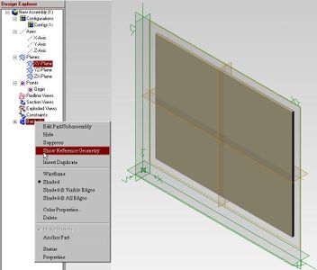

Open a New Assembly and select the Back part to Insert into the Assembly. Insert it away from the origin, so it will be easier if we have room to work. Right click on Back <1> in the Design Explorer and turn on the Reference Geometry. We will constrain the Back using the Reference Geometry.
Step 9: Line 'Em Up
Using the symmetric constraints when we made the parts makes it easier to constrain the parts about a center when arranging these parts in the assembly. We need to rotate the Back, because the grain is currently oriented horizontally because the part is laying on its side. Rather than taking the extra time to use the Rotate or the Precise placement commands to re-orient the Back, we can orient and locate the part using just the assembly constraints. Select the reference plane that goes horizontally through the center of the back, and constrain that to the YZ plane in the assembly space. Image 1
The Assembly Constraint dialog box and the directional arrows makes constraints easier in Assemblies than in Parts, I think. The image shows the selected planes. When we apply the constraints, the arrows will be facing (or mated) to each other. (If they were going to point in the same direction, they would be aligned). It helps to add a description to the label that describes the constraint. When the constraint list gets longer, the labels will be very helpful to locate the proper constraint. Image 2.
The next constraint will locate the back Vertically. Select the now horizontal plane for the back, and the horizontal XZ assembly plane. This will locate the Back as centered Left and Right, as well as vertically in the Assembly space. Images 3.
