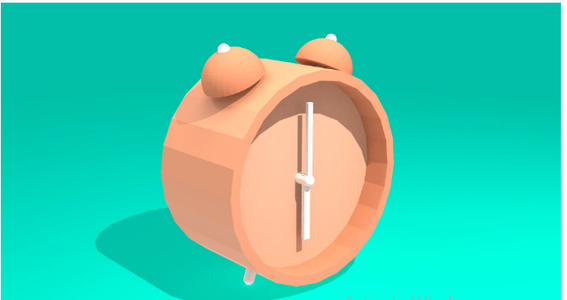

Once you’ve launched the editor;
From the 3D Shapes category on the Toolbar choose Cylinder; Set Height to 30, Position y to 10, Rotation x to 90
Click to finalize cylinder
From the 3D Shapes category on the Toolbar choose Shape generator
Set fill top to false, top radius to 50, fill bottom to false, bottom radius to 50, number of edges to 24, extrusion height to 60, position y to 10, rotation x to 90
Click to finalize shape generator
From the modify category on the toolbar choose add thickness; Set thickness to 5
Click to finalize add thickness
From the 3D Shapes category on the Toolbar choose capsule; Set top radius to 3, bottom radius to 3, height to 15, position x to 20, rotation z to 20
Click to finalize capsule
From the 3D Shapes category on the Toolbar choose capsule; Set top radius to 3, bottom radius to 3, height to 30, position y to 100, rotation z to -25
From the 3D Shapes category on the Toolbar choose sphere; Set radius to 16, arc to 180, position x to 30, position y to 103, rotation x to 270, rotation y to 25
Click to finalize sphere
Click on mesh 12, mesh 8 to select
From the utilities category on the toolbar choose mirror; Set direction to left, create copy to true, offset to 15
Click to finalize mirror
From the 3D Shapes category on the Toolbar choose capsule; Set top radius to 3, bottom radius to 3, height to 50, position y to 55, rotation x to 90
From the 3D Shapes category on the Toolbar choose cube; Set width to 4, height to 35, depth to 2, position y to 26, position z to 20
Click to finalize cube
From the 3D Shapes category on the Toolbar choose cube; Set width to 3, height to 40, depth to 2, position y to 58, position z to 22
From the 3D Shapes category on the Toolbar choose cube; Set width to 30, height to 30, depth to 12, position y to 40, position z to -19
