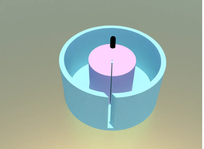

Designing a tape roller involves understanding both ergonomic principles and functional mechanics, particularly the integration of rotating and stationary parts. SelfCAD, with its robust 3D modeling and sculpting capabilities, provides an ideal platform for creating precise, interlocking components such as rollers, handles, and cutting edges. This article guides the reader through the step-by-step process of modeling a tape roller using SelfCAD. By the end of this guide, readers will have a functional digital model that demonstrates both mechanical logic and design efficiency, suitable for prototyping or manufacturing via 3D printing.

From the 3D Shapes category on the toolbar choose cylinder; Set height to 50, vertical segments to 128
Tick the checkmark to finalize cylinder
Click to activate polygon selection; Click on highlighted region to select it
Click delete button to delete selected objects
From the modify category on the toolbar choose add thickness; Set thickness to 5
Tick the checkmark to finalize add thickness
From the 3D Shapes category on the toolbar choose cylinder; Set top radius to 5, bottom radius to 5, height to 50
Click highlighted part on selection cube to turn off region selection
Click on mesh 4 to select it; Click stitch & scoop on the toolbar; From the tool panel choose union.
Tick the checkmark to finalize union
From the 3D Shapes category on the toolbar choose cylinder; Set top radius to 25, bottom radius to 25, height to 45, vertical segments to 128, position y to 6
From the 3D Shapes category on the toolbar choose capsule; Set top radius to 3, bottom radius to 3, height to 20, position y to 45, position z to -20.
Tick the checkmark to finalize capsule
Click color picker button to change color of object; Click black.
Click ok
Click on mesh 12 to select it. Click on mesh 16 to deselect
Click color picker button to change color of object; Click lavender
Click ok
Click on mesh 16 to select it
Click on union 1 to select it
Click stitch & scoop on the toolbar; from the tool panel choose difference, Choose union 1 to subtract, and set keep subtracted object to true
Tick the checkmark to finalize difference
From the 3D Shapes category on the toolbar choose cube; Set width to 1, depth to 25, position y to 5, position z to 14.
Tick the checkmark finalize cube
Click on difference 1 to select it
Click stitch & scoop on the toolbar; from the tool panel choose difference, Choose mesh 20 to subtract, and set keep subtracted object to true
Click on difference 2 to deselect
Click move on the toolbar; Set z to 53 using highlighted gizmo
Click scale on the toolbar; Set x to 5
Click rotate on the toolbar; Set y to 320
Click ‘x’ to close transformation panel
