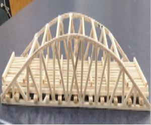

Step 3: Archs
Here you can see the template options if you choose the arch. Archs are very effective since they "spread" the force. You can modify the height of the arch with the drop-down menu below the arch selection. If you are aiming for a cheap bridge but want to use an arch what you can do is use the default settings but connect the members in an arch like in the title picture.

- If you are using an arch design similar to the title picture then make sure the arch is strong, it is under the most pressure.
