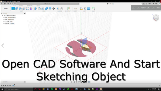

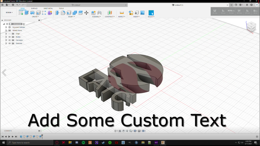

Open the computer and start your preferred 3d
modeling program. Start a new project to start making your part. You can make whatever you wish to print here.

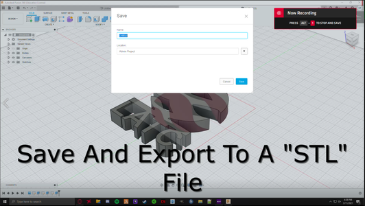

Step 2: Export to STL
Once finished save and export to an STL file. These are the files the slicer can read in order to tell the printer where to go when printing.

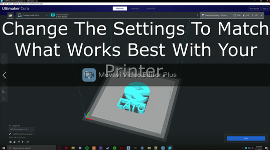

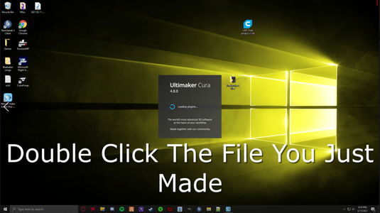

Open the “CURA” program. Once the program is open drag the file
over the window into the blank area. This opens the file and prepares it to be sliced.

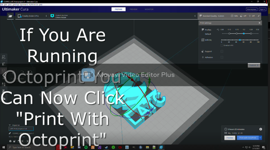

Some settings have to be changed to help print the object. Supports are needed if there is an angle that is more than 45 degrees. This helps the printer and prevents the overhang from falling over. Once everything looks great and the computer doesn’t mark any flags click “Slice” and the computer will produce a file for the printer. Always check the “Prepare” tab to double-click the finished project. Finally, click “Print With Octoprint”

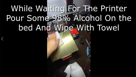

Turn on the printer and while it is warming up, pour some rubbing alcohol on the bed and wipe it with a paper towel to clean off any dust that may impact the print.

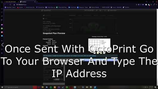

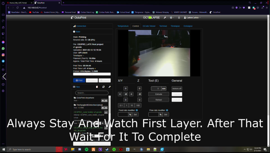

Step 5: Open OctoPrint
Open Octoprint and monitor the print. Always watch the first layer to make sure it adheres to the bed to have a successful print.
