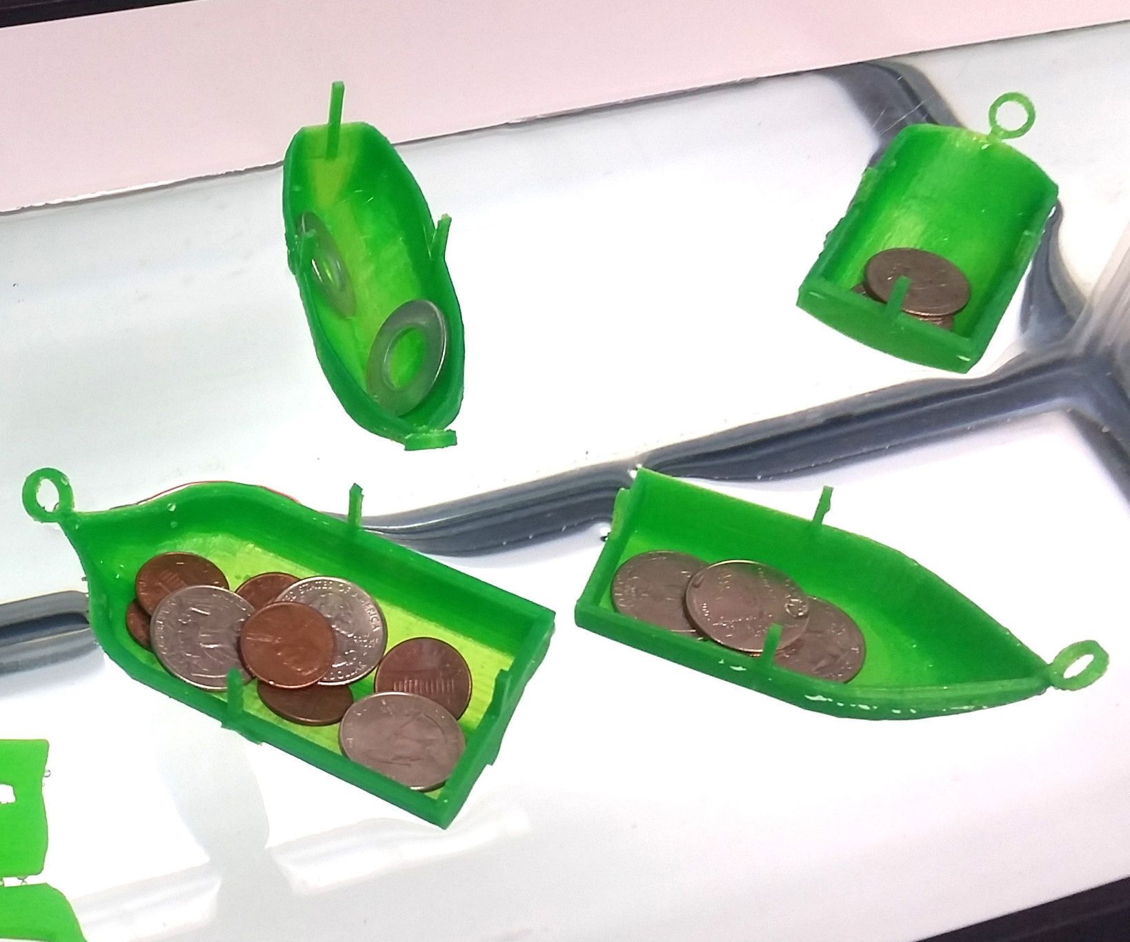

Students will be engaged in a hands-on activity to test the efficiency of various cargo boat designs. In testing, students will collect data using 3D-printed boat models and determine which design is superior in terms of total cargo mass. Students will explore scientific approaches, engineering design, and mathematical applications, namely developing a procedure to select a boat while meeting several constraints. In part 2 of the activity, students will have the opportunity to design their own boat prototype.

Open the files in you preferred slicing software and arrange them to fit on your printer. Print all the boats in one build, with the ramp in a separate build.
A few suggestions for setting up your slicing settings so that your boats are watertight.
- Print the models relatively slowly.
- Make sure you set the same amount of infill for all boats so that their density is comparable.
- For the ramp, set the layer height to 0.4mm/layer and 5% infill.
- For the boats, set the layer height to 0.3mm/layer and 35% infill.
If you are printing using PLA, you should not need a brim, raft, or supports.

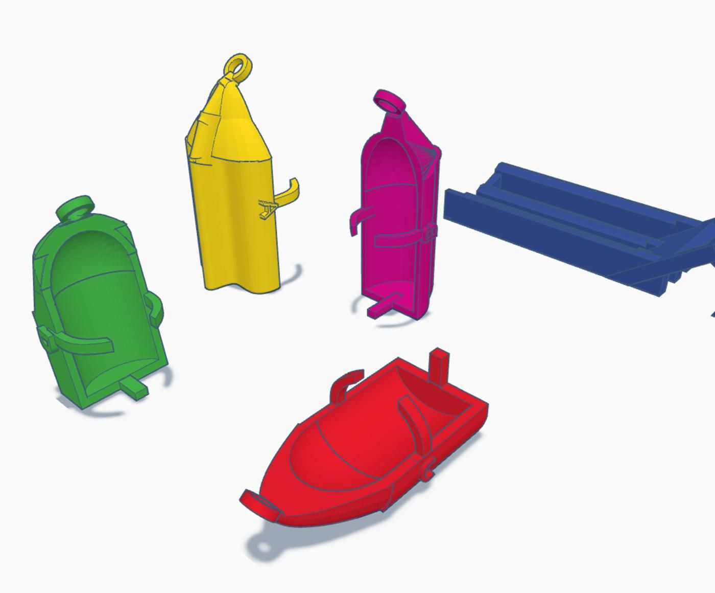

Before you start modeling your boat, you'll want to design it on paper first. The best strategy is to draw your boat from three main orthographic perspectives: Top, Side, and Front/Back.
While designing your boat, think not only about how it will interact with the boat ramp and how it will perform in your tests, but also about how it will print. The boat will need at least one flat side to print well. If you want a keel or other slope on the bottom of your boat, consider making the back of the boat flat, for example.
Also be sure to include the side and back pegs and front hook in your design so you can run the same experiments on your boat as you did with the pre-designed ones!

To name your boat, you'll use the awesome TEXT shape generator in Tinkercad, available under the Text or Basic Shape tabs in the dropdown menu on the left. For simplicity, we named our boats A, B, C, and D. Feel free to name your boat whatever you'd like. Just keep in mind the font needs to be pretty large so it can print well.
Select the side of your boat as your Workplane by dragging the Workplane in the left-hand column onto the side of the boat. Drag the TEXT shape generator onto the side of your boat and choose your font and name. Type the name into where it says "TEXT" and scale your name to fit on your boat. Make sure it fully connects with the boat. I always overlap the letters with the side of the boat just to be safe. Then, Group all objects to complete your boat design.
