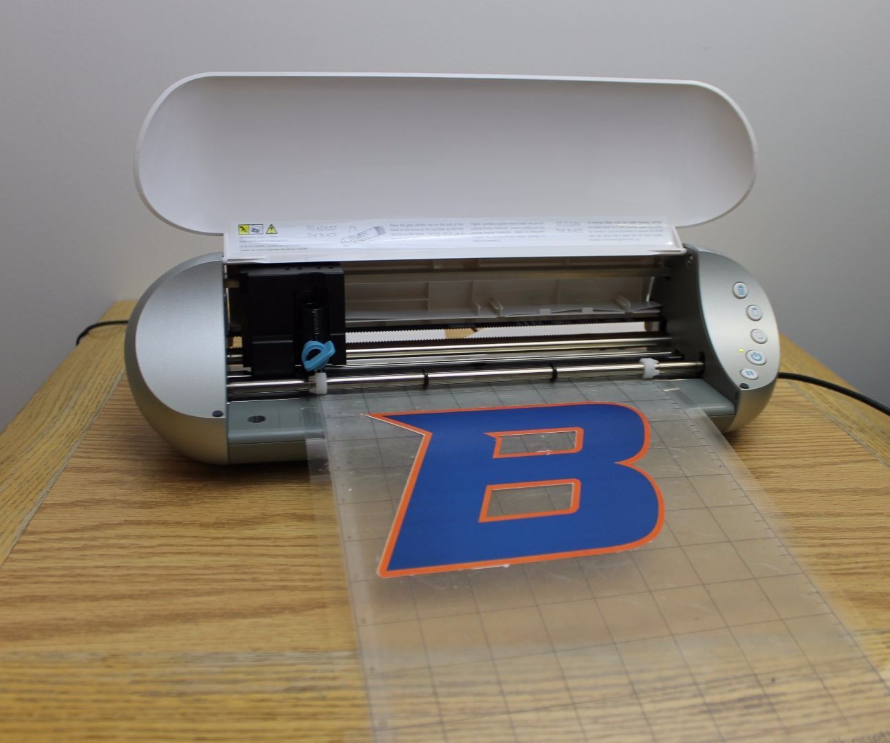

The Silhouette Portrait is a user-friendly electronic cutting machine. It can cut anything from card stock to vinyl, so you can make stickers, posters, or even 3D objects. With all this opportunity for creativity, it can be overwhelming getting started. This tutorial will take you step by step from idea to full-fledged design. Let's get started!

Step 6: The Finished Product
I liked the design I made in the software much better, so that is the version I decided to cut out. Now that I've got my finalized design I can cut as many as I want, and even make a stencil. The possibilities are endless with the Silhouette Portrait, so have fun and get creative!
