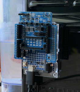

We will do it in a total non intrusive way, we only put an Arduino board with an accelerometer on the coffee machine.

First plug the STMicroelectronics shield on the Arduino board and then use blu tack (or any other adesive) to put the board on the coffee machine.
