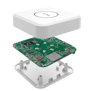

The DSGW-210 IoT Edge Computer Gateway is a programmable IoT Gateway designed for the IoT Gateway Developer. It provides reliable connectivity for a wide range of wireless IoT devices, including Wi-Fi 2.4G/5G,Zigbee3.0, Bluetooth5.2 and Z-Wave, LoRa, LTECatM1, LTECat1, LTECAT4, Matter&Thread, ECC,GPS. Here are instructions on how to Start Wireless Development on DSGW-210.

DSGW-210 is an off-the-shelf hardware solution with developer preferred ARM-based processor (RK3328) running pre-built Linux Debian 11. With customizable memory storage (RAM up to 2GB and eMMC up to 32GB), it provides powerful edge computing capabilities for local operation (cloud & cloud free).
Rich built-in wireless connectivity (BLE/Zigbee/Z-Wave/LoRaWAN/Wi-Fi/Matter/Thread/GPS/M-Bus/Sub-GHz) and sufficient WAN and LAN ports are ideal choices for IoT hardware developers to customize based on diversified IoT applications such as smart home, building automation, energy management and more.
