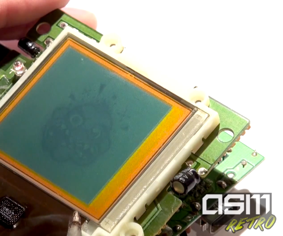

Step 6: Removing the LCD Circuit Board
Before removing the LCD, we recommend adding a piece of painters tape to secure the speaker to the PCB to avoid ripping out the wires.
The front LCD circuit board has several more Philips head screws that need to be removed.
The LCD is supposed to be adhered to the plastic shell, but the glue is generally dried up and will remove with ease. If it does not remove with ease, carefully pry the LCD up from the plastic. Optionally, if the screen cover is detached, you can push on the LCD from the outside. This is more often an issue with the "Play It Loud" series Game Boys as they are newer and sometimes have the adhesive still intact.
Step 7: LCD Screws
If you intend on doing any LCD modifications, you will need to remove the final two screws over the LCD's ribbon cable. You will need a smaller Philips head screwdriver to remove these.
These screws are threaded directly into the PCB, not the plastic supports from the LCD's frame, as these act solely as spacers.
