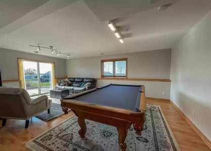

Introduction: How to Disassemble a Pool Table
You can disassemble your own slate top pool table for transport. To reassemble just reverse the process.
