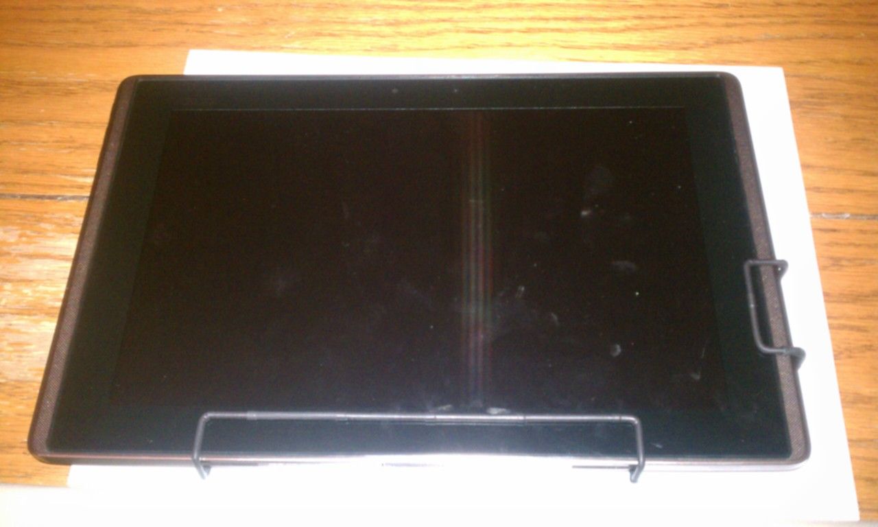

How to Disassemble the ASUS Transformer TF101 Keyboard Dock
Introduction: How to Disassemble the ASUS Transformer TF101 Keyboard Dock
This tutorial will guide you through how to disassemble the ASUS Transformer TF101 keyboard dock.
