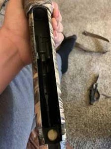

Step 2: Take Off Cap
Once the gun is found unscrew the cap underneath your barrel. When the cap is taken off make sure the spring and the plug do not fly out. If they fly out, find everything that may have been launched out of the gun and put it back in its place. Make sure the pieces are put somewhere where they will not go missing.

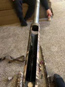

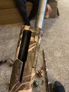

Step 3: Barrel and Foregrip
After the cap is off, pull the foregrip off and the barrel off then set them aside with the other pieces. Be careful that the barrel does not hit the little cap at the end of the shell tube.

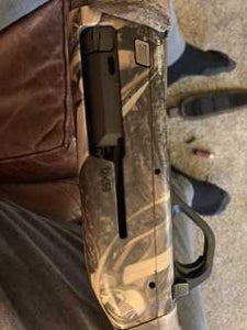

Step 4: Pieces After the Barrel
Following taking the barrel off, take the pieces off that are under the foregrip. There should be three different pieces under the foregrip. Remember how the gun was taken apart so it can properly be put back together. Once again keep a close eye on all of the pieces.
Step 5: Firing Mechanism
Take out the two pins that hold the firing mechanism and the action in and it is completely dismantled. Make sure the pins are in a spot where you will not lose them. Repeat the steps in reverse order to put the gun back together.

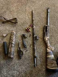

Step 6: Pieces
All of the pieces.
